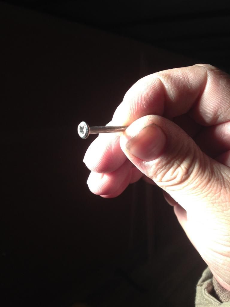

One problem I've already ran into is getting the interior paneling off....Diamond used the nails with the screw heads (pic attched); which don't cooperate very well when trying to pull them off. I find on some I can pry between the stud and the luan and using a drill some will "screw" out. But on others whenever I do that, It will pull the nail through the luan without even trying. Any tips would be appreciated. I plan to rivet the luan back on the studs when finished, so trying to leave the panels MOSTLY unscathed.

On the nail screws . . . :thinking: Me thinks yur gonna have to drill the heads off the ones that won't back out, using a drill bit that's slightly larger in diameter than the shaft of the nail to keep from making the hole in the luan wider. Remove the luan, then use locking plyers to unscrew those nails. Even if the luan gets buggered up, one can always use some wood putty or paintable caulking to fill the imperfections and then paint it. (I painted half the luan in my trailer a light tan and it really helped bounce the light around better than the natural, darker color of the wood.)

I got most the trailer insulated today. I just ended up pulling most the screws through the luan. It flattens back out pretty good once I rivet it on. Using 3 rivets per stud. I only had to pull the uppers off anyway. The foam board is JUST flexible enough I can work it down behind the lower sheets. Breaking one out of 38 isn't bad!
Not super worried about imperfections on the Luan as I plan to carpet the walls and the rivets are sitting flush against the board.

My trailer has the same nails, but I knew it going into the purchase, so knew I would have to deal with it. I have 3/8" plywood interior, but had I purchased a luan interior, I had planned to just peal off the luan by pulling the head through the sheet, cut the heads off and replace the luan. Much less frustrating than trying to remove the nails since luan is so thin and cheap.
With 3/8" plywood, I am hoping the counter sinking into the plywood is strong enough to withstand drilling, but not sure how this will end. I will know on Saturday, as the interior gets pulled this weekend.

On my build, part of the solution to getting my panels off was to use 2 or 3 pry bars to lever most of a full edge up at a time. With more of an even pressure across a larger area, I had better luck on getting the panels to pop off with little damage. I still had some pull through.
I also tried to drill them out first. It didn't work. They just spun in the hole.
In putting my panels back up, I used the same holes but added a washer on my self tapping screws to cover the larger holes that some of the screws pulling through had made. Good luck! They were a PAIN!

I'm using rivets with new holes mounting in the studs. The rivets suck the luan down just where I want it...nice and flush. Not super worried about the thermal rating on the carpet as I'm insulating the trailer. I like the way it looks! I'll be done with the insulating tomorrow morning and hopefully I get my 120 to 12v converter in the next day or so, so I can start to play with the stereo and other goodies I have on the way......Just waiting on Ebay. Have 40' of LED strip coming with controller and 12v power source.

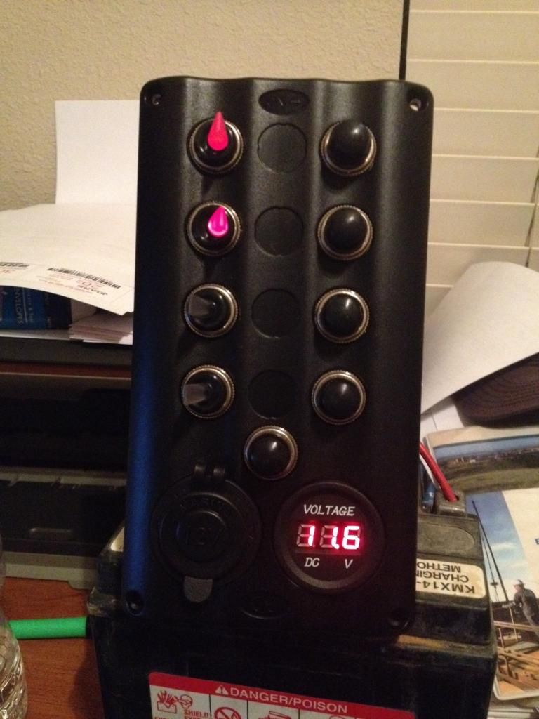

Sweet little switch bank I ordered came in today. It has 4 fused 20a circuits, voltmeter and cigarette plug. Should go nicely with the 80a 120 to 12v converter that should be here tomorrow!
