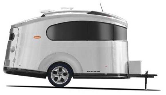

Postby fourbtgait » Thu Dec 04, 2014 10:46 pm
To long.
12' maximum length, even then 10' would be better. A lot of the roads I traveled this summer were single track national forest where even in a jeep or 4runner you hope you dont meet anyone.
Though the basic shape you show is along the lines of my thoughts.
One thought on the cargo was to push the queen bed back to the doors, make it fold for a sofa, raised off the floor. Reason? To fit a pontoon boat partially deflated under it.
Or a deer/elk in the front portion for the trip home.

Postby Prem » Fri Dec 05, 2014 10:21 am
That Airstream is beautiful. The homebuilt Roundtail was fashioned after it in the tail section. The Airstream is more aerodynamic because it is narrower and lower and round (vertically) in the front. The homebuilt has more square footage, 6 ft. 2 in. of standing headroom with a 6 ft. tall RV door. Rick, the owner gets 1 MPG more towing it at 55 MPH than not towing it with a Chevy Blazer.
