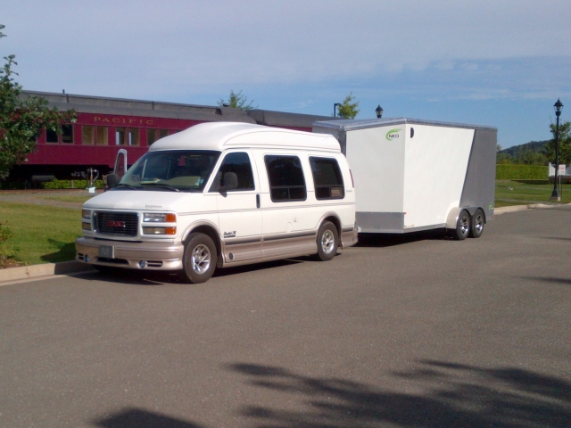

Finally figured out how to post pictures, so here is one taken in New Brunswick on our cross-Canada trip back in Sept/2014:

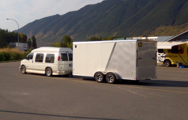

The trailer doesn't look all that large from the front but when you view it from behind:
you get an idea of its real size.
