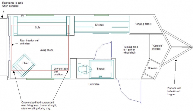

Here is the plan for my build.
I'm starting with a 2014 NEO NAVR716TR6 trailer – 7'x16' with an interior height of 7'. The V-nose adds approximately 22" inside. The side door is 32" wide. Rear ramp. All aluminum.
To start I figure we will mostly plug in to park power, so I plan to install 110v panel, wiring, lights, etc. Future addition might include 12v and solar. Propane tanks will sit on the tongue and be connected to fridge, stovetop, furnace, and on demand water heater.
One major factor in the decision to convert a cargo trailer was my wife's power wheelchair. She is ambulatory but uses it to go longer distances, thanks to having polio as a kid. So the ramp will allow her to use her wheelchair in the trailer and the area at the front provides enough space for her to turn it around.
The key to this plan is the suspended bed over the living area. With 7' interior height, there is sufficient room to store the bed in the ceiling and be able to walk under it. My wife and I did look at various small "lite weight" travel trailers with permanent beds (neither of us wants to make a bed at night then put it away in the morning, day in, day out!) but they were just plain awful – expensive, poor fit and finish, and really crummy layouts.
Using the space at the back of the trailer as a living room during the day and a bedroom at night meant everything fits into a 16-18' trailer. And 7' wide means an easier tow.
Finally our high top conversion van, according to the specs, can tow a maximum 6,000 lbs. Converting our CT means we can control the weight, keeping it as light as possible.
I'm starting at 1870 lbs empty. I'm interested in seeing what it ends up weighing when I'm done.
I would appreciate any comments, criticisms, concerns, and suggestions re my plan.
Thanks!

CoventryKid wrote:Finally our high top conversion van, according to the specs, can tow a maximum 6,000 lbs. Converting our CT means we can control the weight, keeping it as light as possible.
Thanks!
Doug
Doug, My weight limit is only 3500 pounds...WITH a 480 pound motorcycle in the trailer during transport. As a result, I put together a weight matrix by major component using published weights to ensure we could keep the build under 3500 pounds. The number one result of this was the elimination of the ramp door and purchase a 14 foot trailer instead of 16 foot. Based upon my matrix, you should be able to stay within your weight limit, but will need to pay attention to the little things, as those pounds sneak up on you...

I too have started to keep a weight list of everything added. I start with about 1750lbs.

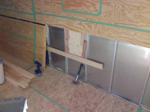

In the great green north today, it was 12C (54F), so plenty warm enough to start stripping out some plywood....
I took off the lower sheets of plywood (thank you NEO for using real screws!) and cut a piece of plywood as backing for the utilities. Tomorrow, if the weather cooperates, I'll install the 30A service plug, the city water input, and cable input.
I think we've finally got the windows sorted out. We like the T windows we have in the van, so I'm looking for similar for the living area at the back of the trailer. I mocked up this picture of the trailer this afternoon.
I might be off a tad but at least it gives an idea of what it will look like.
