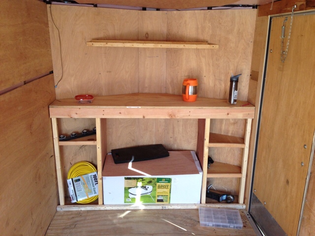

Postby CargoPete » Sun Dec 07, 2014 10:26 pm
Here's what I built so far, nothing fancy just some place to store stuff.
