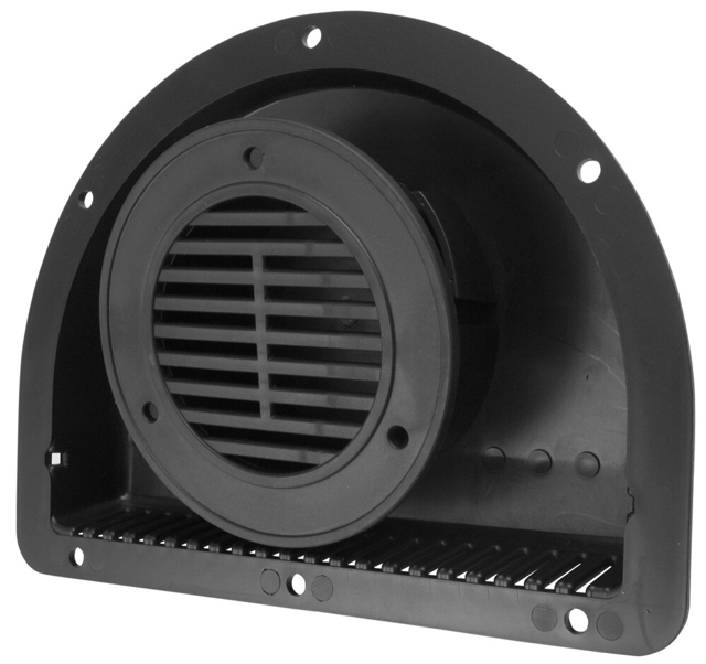

Postby abqlloyd » Wed Dec 24, 2014 3:37 pm
So something like this, underneath the floor, facing rearward, might be enough to vent any gas that settles?

Postby hankaye » Wed Dec 24, 2014 9:03 pm
abqlloyd, Howdy;
Merry Ho-Ho! The propane compartments in my 5th wheel have 8" dia. holes under each tank
(one on each side of the trailer), also the 'Code" that the RV manufacturers follow calls for the
doors to be non lockable for access in an emergency. Just some thoughts for you to consider ...
hank
