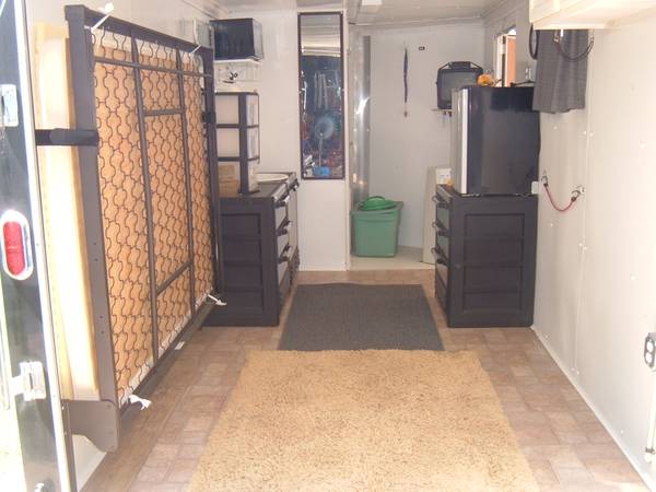

I have a folding bed in mine. It was built by someone else a few years back. I did remove the bed frame from the metal brackets in the wall. When I did, I took out several "Lag" bolts and one that had the nut and bolt. The nuts and bolts on the left brace, closest to the ramp were accesable only there, but the lag bolts were used in all the othe brackets (only 2 brackets for the fold down). So far I decided to leave them in that position to have more room when folded up.
You can see what I mean by pics in my Gallery.
