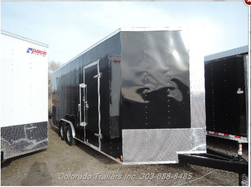

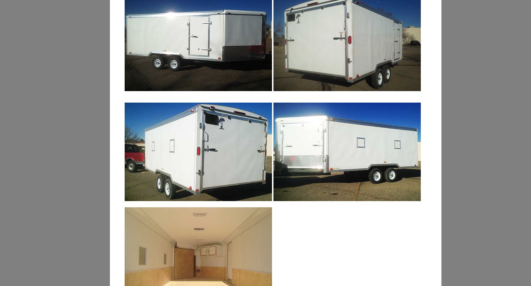

Postby Wookie97 » Mon Feb 16, 2015 8:38 pm
Attached are pics of the two trailers. I am pretty confident in my welding ability and could fab brackets to raise the ground clearance of the Black Car trailer. But if I don't have to and the Snowmobile trailer works why go through the trouble. From the description the walls on both are 16" OC. The main difference is the Snow trailer is rated for 7K and the other for 10K. Also the inside height of the Snow is 6' 1" and the Car is 7'.

Postby Padilen » Mon Feb 16, 2015 9:08 pm
Thanks for posting the pics.
Ok I see that there similar to what I looked at. Much bigger
What is your use? Insulating? Do you need the extra weight capacity? Or is interior height what's needed.

Postby crumvoc » Mon Feb 16, 2015 9:11 pm
Unless you live in the arctic, I would recommend a lighter colored trailer. Black would be Hot Hot Hot in the summer. Also, not sure if it is a photographic artifact, but that black trailer seems to have some gnarly/bendy looking panels on the front. Let us know how it goes!

Postby Padilen » Mon Feb 16, 2015 9:24 pm
I thought that was the pic- hard to see on cell phone. But the thickness of the skin may be different too. I found it was very hard to shop for myself so I'm not going to be much help.

Postby Wookie97 » Mon Feb 16, 2015 9:38 pm
It going to be a dual use trailer. Im in the military and have to move every so often and there are some things I will not all them to move, then I use the trailer. Here in Colorado I do a lot of hunting and camping with the family. They like to have some creature comforts besides a tent. Majority of the time the trailer would be used for general off grid camping and hunting season. Eventually I would be taking a quad or two manybe one quad and a SS. I prefer dirt bikes but have to make the wife happy some.
I went an looked at the black one a few weeks ago and there is nothing wrong with the siding, must be the way the pics were taken. Besides ride height, the other thing I was looking as now was interior height. The 7' inside height of the Black one is nice, not sure how the 6' 1" of the Snow will be. Guess we will see this weekend when I go look at them again. I may be leaning toward the Black one.
Oh, yes there will be insulation going in the walls. I was debating on the color as well. I know the Black would get hot in the summer, they have a white one also I may look at. Black just looks better to me. LOL
