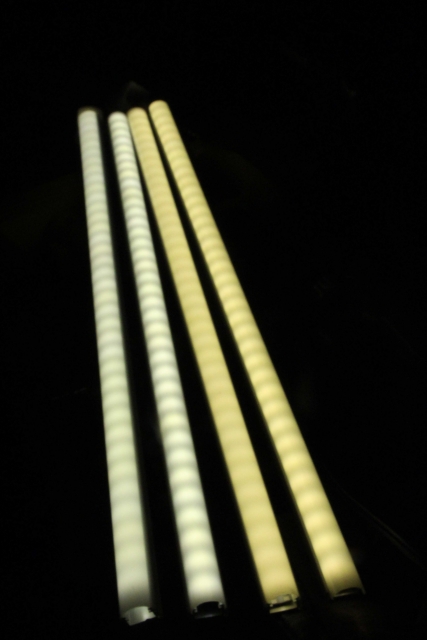

Postby lrrowe » Sat Feb 21, 2015 11:43 am
I just received four chineese led light strips for my main lighting in my CT. I thought I had interpreted their lumen chart correctly, but not only did they send me two different colors (warm and cool white), the lamps together do not produce enough brightness for the trailer. While I only tested them in the garage, I am convinced, I would be disappointed in the CT also.
So I am back to searching for low priced alternatives. I have tried to search this forum for recommendations and found many, but they do not suit my needs.
My new question is for you CT'rs out there, what level of lumens from a 12V LED lamp have you found to be adequate for the main lighting in the trailer. I used one 100 watt (800 lumens) AC bulb last fall while hunting with black plastic on the walls. In that instance, I would think I need 200 watts (3200 lumens total). In a lighter walled and ceiling room (6 x 12 ft) I think two 60 watt bulbs might work. That would be about 1600 lumens total (reg. http://lumennow.org/lumens-vs-watts).
Do you think I am close in my calculation to what I might need. I want ceiling flush mounts. An alternative might be these lights which others have posted on this site.
http://www.amazon.com/Gold-Stars-F35280 ... led+lights
But they are only 150 lumens each and would need about 11 to get to 1600 lumens. At the Amazon cost that 12 pieces would be $100 which I think is quite high.

Postby lrrowe » Sat Feb 21, 2015 6:10 pm
Jerry, the 200 watts post was just to demonstrate the amount of light that works for me in AC. No, I would not use AC for this application.
Lumens is the standard measurement I am using to compare one light to another.
Paul, these lights are 680 lumens each (see further down in your link) and I believe 2 or 3 would work for me. And the price is right. Yours are in Australia. I quickly tired to find the same here and had no luck in the first try. I will continue to try. It is beer and stew time now.
Thanks to both of you for your comments so far.
Edit:
These lamps are what I just got and I am very disappointed in them. I ordered 4 of the warm color and got two warm and two white. And I expected them to be as bright as yours Paul, they do not appear to be.
Bob

Postby teddy » Sat Feb 21, 2015 6:21 pm
My experience with electronics bought directly from China is that not every part of the specification is correct, they tend to exaggerate a bit. Usually i divide the rating in half to get the real specs.
