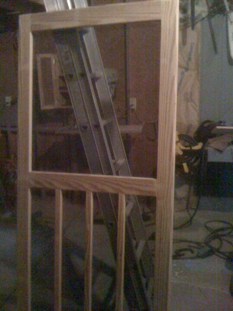

Postby backstrap bandit » Wed Mar 04, 2015 2:36 pm
Something like this

Postby backstrap bandit » Wed Mar 04, 2015 2:39 pm
I built this one much better quality than store bought for a fraction of the cost and best thing you can build it any size and repair it yourself been up for about 5 years now

Postby 2Tornadoes » Wed Mar 04, 2015 5:40 pm
Bandit, great job on that screen door! Can you post a few more pictures of different sides? We might try the screen-curtain concept this first summer but will probably want something sturdier in the future. With something like this you could even add a metal grate or something on the lower half for pups (and kids).

Postby backstrap bandit » Wed Mar 04, 2015 5:51 pm
I don't have anymore pics and this door is on my uncles house but this door is all but joints put together with pocket holes and screws then on back staple screen and cover staples with latice strip you can even put screen door knob and latch on this one is made from 5/4 treated deck boards ripped down if u need more info more than happy to help

Postby backstrap bandit » Wed Mar 04, 2015 5:58 pm
Usually if someone has kids or animals I will put hardware cloth(rabbit wire over screen to keep it from getting kicked out or torn up

Postby SalsaDog » Wed Mar 04, 2015 7:18 pm
backstrap bandit wrote:Something like this
That looks very nice. How do you incorporate it with the door? I.E. does it open with the door or does it swing in. I don't want to open
two doors to get out. The trailer manufacturer wants $275 to add a screen door. I'm thinking the door jab would need to be wider?

Postby backstrap bandit » Thu Mar 05, 2015 5:18 am
Thanks yes you have to open it it's a screen door do a home hung on hindges but you could put a piece of channel at bottom of door for something like this to set in and then add a couple of clips at top and sides to hold it on but also allows for removel
