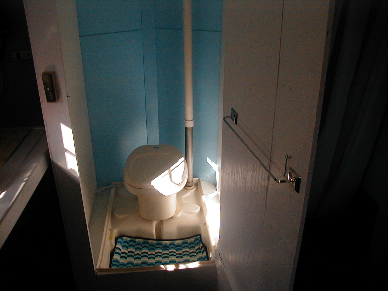

I would like to put both in the "v" nose, but the underside is a conglomeration of triangles, trapezoids, and brace plates.
I could go in on the left wall, but want the other location.
Just curious if anyone has installed both up front. I have seen a shower installed there, on here, but not the toilet up front??
Ideas appreciated. There is so much knowledge and experience on this site....Thanks. :crazy:

I placed this in the "V" and adjusted the location to avoid the braces. Its a combination shower and toilet. The holding tank is inside under the toilet not under the floor. Just the sewer pipes under the floor.

Doublacola. Where did you find that one?? It looks good also. I see it's vented. Does the vent work for the shower drain also??? It might be more of what I'm looking for.
Thanks.

I wanted a one piece shower/toilet/sink combo& holding tank.. Found a pick-up camper to tear down with one. But the fiberglass needs to be refinished. So I'm not using it my new idea http://www.rvpartsnation.com/product/15 ... shower-pan. It was suppose to be ordered this month but other expenses came up.

Chasg1 Just like Padilen said. I found an old camper that was being torn down. The vent does not vent the shower but so far its drained just fine. I have seen these bases for sale in catalogs. I have also seen Jwhite's creation and its interesting. He took a porta potti, cut a hole in the bottom, and adapted a flange to the bottom of it, cut a hole in the floor, and piped his waste out to the side. A very economical alternative.
