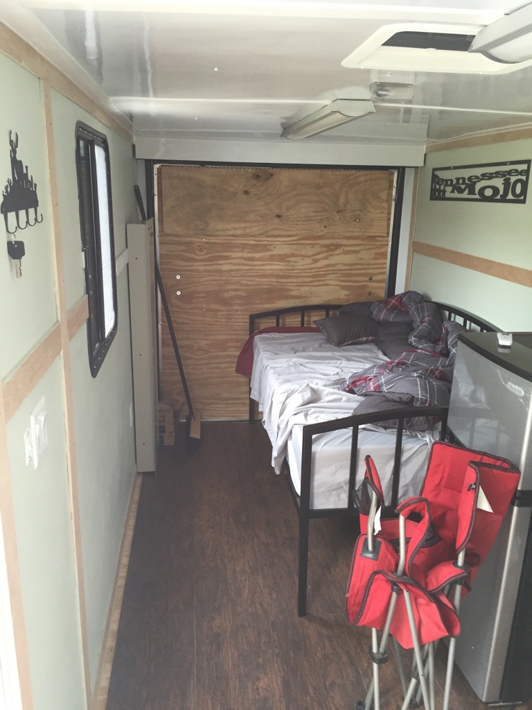

Postby Gunman9 » Fri May 29, 2015 9:07 am
For anyone that has installed one... How did you go about it? I did not insulate my roof and I really don't wanna tear it down inside because the factory installed vinyl ceilings and LED lights. Do I need to reinforce it or will it be fine without any reinforcing? I don't travel very long distances with the trailer. Also what screws did you use to screw it down? I was thinking self taping would work nicely.

Postby Gunman9 » Sun May 31, 2015 7:20 am
So do I need to reinforce the roof or now lol I like the suction cup idea but this ain't that kind of antenna.
