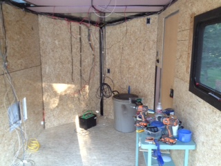

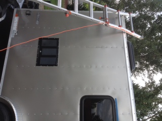

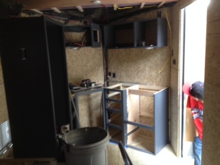

It's coming along...insulated, windows in..cabinets are coming along, no matter how many times I read the manual or look at online resources I still don't have 100% confidence in wiring the PD 4045.
Made some dumb moves along the way but nothing that couldn't be fixed.

What is the square lower hole/cover for?
chiefairwrench
Posts: 103
Joined: Wed Jan 27, 2016 4:47 am
Location: Georgia
Re: 7x14 Conversion--Toy Hauler
Postby jhamm » Thu Feb 25, 2016 11:28 am
The square vent is for a 3 way fridge...there's a vent in the roof directly above it as well to create airflow over the back of the unit.
