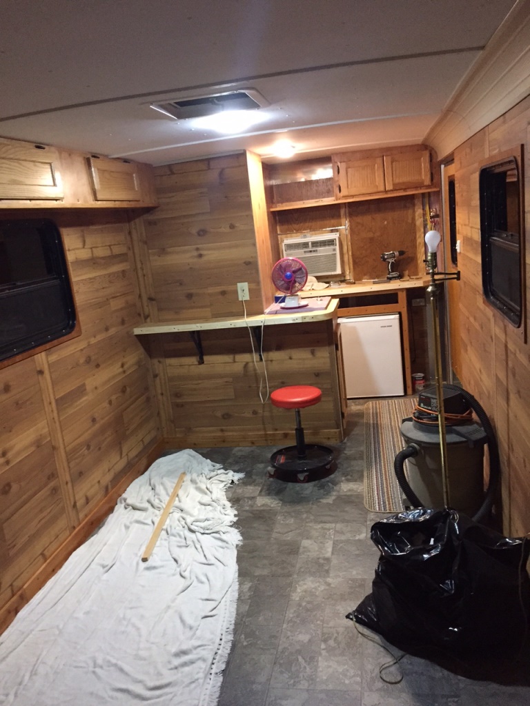

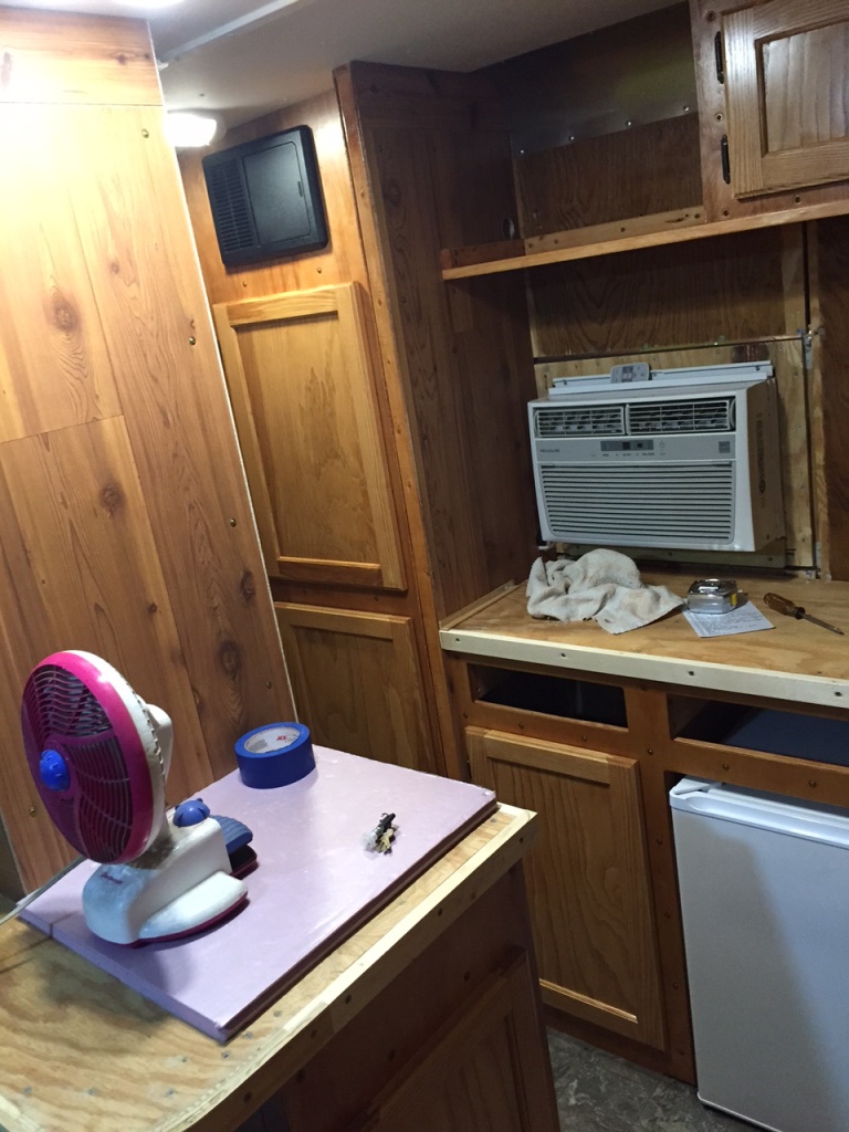

Postby JRinTX » Mon Sep 14, 2015 2:51 pm
A few more pictures of recent progress. Getting close...just in time for fall camping!
Still have lots of details. Need Formica on counter tops and install sink. Area behind cabinet and around the AC will have painted bead board.
Bathroom will have a curtain for the door.
Sink goes under the pink piece of insulation. Need Formica and finish wall around AC.

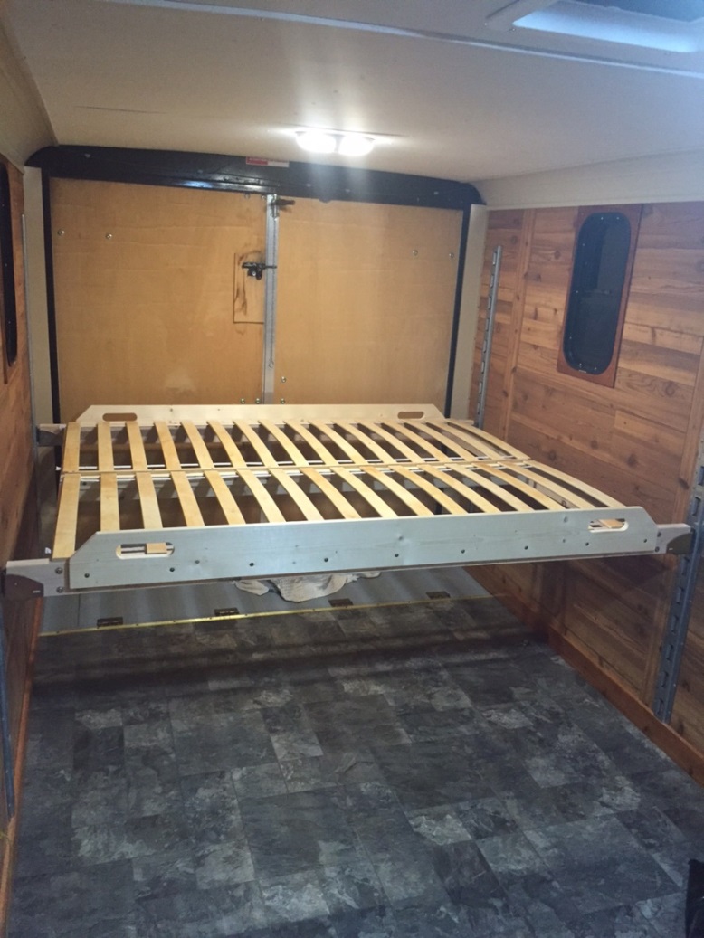

My slatted bed, mounted on vertical E-track.
Back doors are going to get an RV porthole in each door, and rework the latches that were installed by PO.

Postby akula1 » Mon Sep 14, 2015 4:15 pm
I love your bed!
Did you purchase it, or make it from scratch? Do you have any drawings for it? How's the weight on it?
I was going to get a bed frame made out of metal, and band it to two 2X4's and use the e-tracks.
I was also going to connect cabinets up high to the e-track with the 2X4 connectors for easy removal. What do you think?
What did you use for your walls? My wife loves it?

Postby 2Tornadoes » Mon Sep 14, 2015 5:14 pm
Great work! How will it be to move that bed up/down when necessary? I guess you just take the slats off and move each crossbeam one at a time to set up for sleeping or travel? Nice clean design.

Postby JRinTX » Tue Sep 22, 2015 4:12 pm
Sorry for the slow response!
akula1 wrote:I love your bed!
2Tornadoes wrote:Great work! How will it be to move that bed up/down when necessary? I guess you just take the slats off and move each crossbeam one at a time to set up for sleeping or travel? Nice clean design.
I bought the slats from IKEA. The frame is built from 2x4's, with a 1x6 on each side to contain the mattress. The width of my trailer is about 80", just right for the length of a queen mattress. I made the width of the frame 62" (inside the side boards) to trap the slats and hold the mattress. I also added a 2x4 down the center, with a 1x2 on each side, to give the slats a center support. I put a 3/4" x 3/4" strip down the middle of the 2x4 to trap the slats in the center. I hope this makes sense, if not, ask more questions and I can try to explain better.
The slats weigh about 15 lbs. The frame is another 20 lbs. The mattress is a hybrid memory foam over inner springs and weighs about 80 lbs. So, I have about 115-120 lbs. My wife and I can lift each end, using the hand holes, and adjust the e-track brackets. The brackets can easily be moved 2 notches at a time. This way we can "walk" the bed up or down easily. I may look at rigging up a pulley system to make it easier and a one man job.

Postby akula1 » Wed Sep 23, 2015 9:18 am
Thank you for your response. I will be stealing your idea. I am sort of confused on how the double set of slates attach together, and how the center is supported to the frame edge. Pictures of the underside in the center and ends would help.
Do you think there is room to make a 1" thick headboard to slip over the 2X4 supports?

Postby JRinTX » Mon Sep 28, 2015 3:26 pm
akula1 wrote:Thank you for your response. I will be stealing your idea. I am sort of confused on how the double set of slates attach together, and how the center is supported to the frame edge. Pictures of the underside in the center and ends would help.
Thank you very much!
The two sets of slats do not attach together. They are independent and I built the frame to trap each individual set. I also screwed the end slat on each set to the frame.
Here is a drawing that should help explain how the frame is built.
Trailer Bed.pdf
(5.16 KiB) Downloaded 290 times
