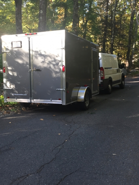

Padilen wrote:That's a nice tow vehicle! Trailers nice too
Thanks,
Ram Promaster van, a Fiat product introduced here in 2014. Front wheel drive, V6, 280 hp. I bought the low roof, short wheelbase model (118") and use it as my daily driver. 5000 lb. towing capacity. I don't think I'd want to tow that much though... My trailer is 1200 lbs. empty. I figure it will be about 2000 before loading the fridge and putting in water jugs. It should tow very well for me.

The Promasters are pretty popular with folks building camper vans. There are pluses and minus's to both but the Promasters are quite a bit less expensive to buy. I had wanted a Sprinter for years but wouldn't/couldn't spend the money they wanted for them. When the Promaster came out I decided it was time to get a van after wanting one for years. The front wheel drive really sold me on it. I didnt want a rear wheel drive as I drive a lot in winter. This does really well on snowy roads. It's also getting 19 mpg (highway) not too bad for a big box...
A diesel version would be nicer for towing but I didn't really want to spend the extra for it, or the additional maintenance costs a diesel has. Plus I just don't drive or tow often enough to really need it.

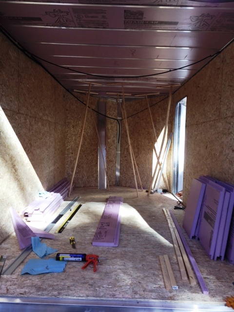

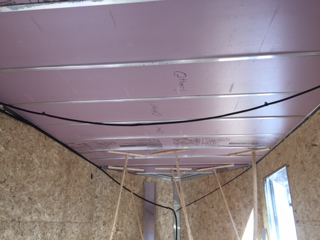

I hadn't planned on starting a build until Spring arrived but we've been having such warm weather this week I figured I'd get started on some work.
Something to do in between raking leaves... :thumbdown:
Installing the first layer of ceiling insulation. Using 1 1/2" XPS between the ceiling beams.
The second layer will be 1" poly-iso. That's all I'll be able to fit and still have head room.

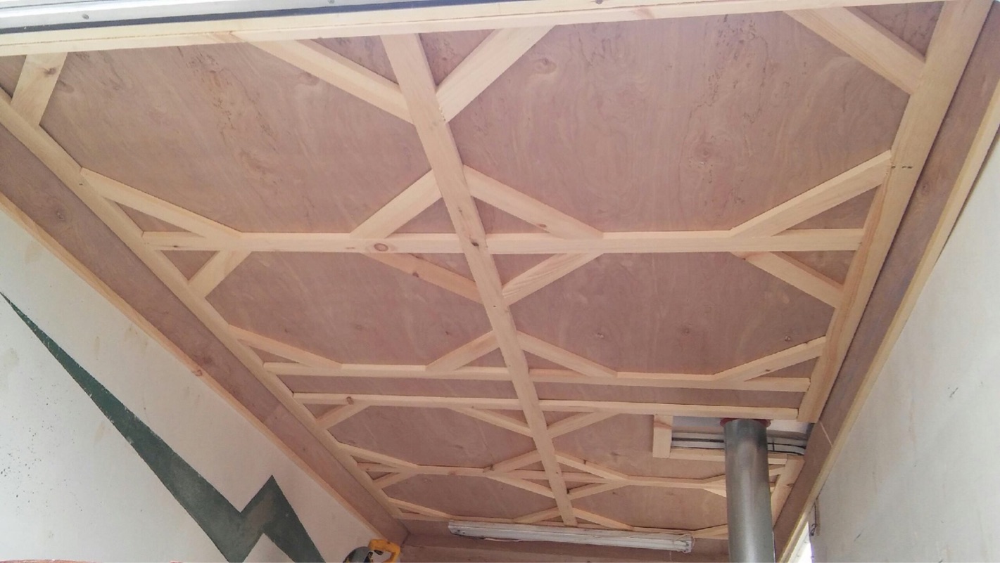

That is a pic of the cargo my brother is currently doing,custom interior roof
Jeepcamper
Posts: 11
Joined: Mon Nov 02, 2015 5:03 am
Re: New Guy, new trailer
Postby makevx73 » Thu Nov 05, 2015 1:31 pm
Jeepcamper wrote:That is a pic of the cargo my brother is currently doing,custom interior roof
Post & Beam look?
