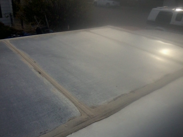

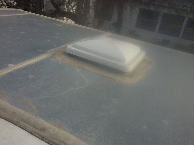

This is the roof on my '06 Pace 6x12. No leaks so far, and I've seen it with 5'+ of snow, -50f to +110f. I got this used from Rapid City, S.D. and their weather aint a whole lot milder than ours. I think they hold up pretty good, but I am going to paint/seal it before I install A/C and bathroom vent/fan and tank vent.

That roof looks pretty good to me. :thumbsup:
