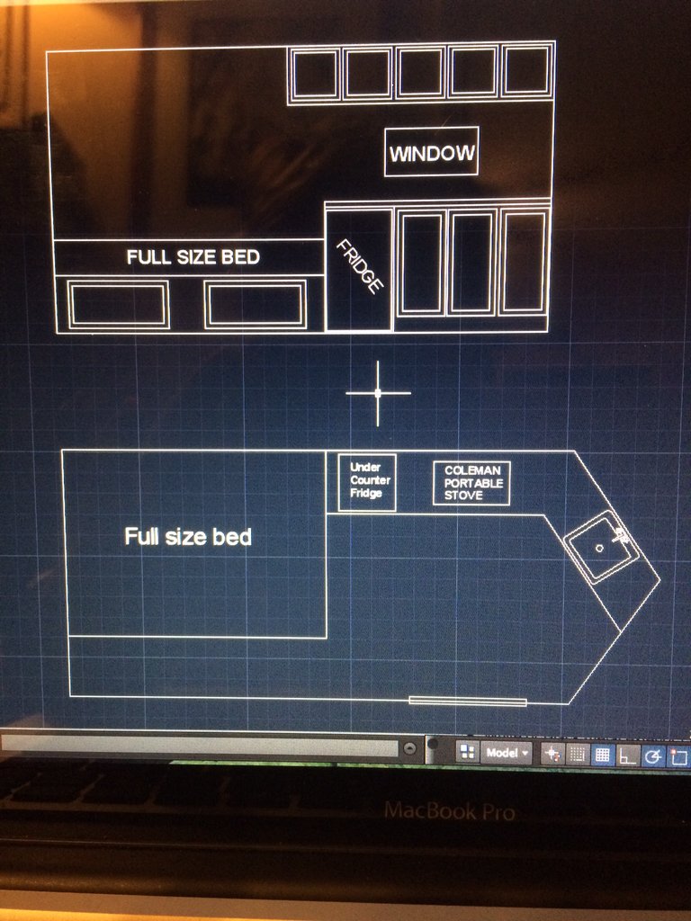

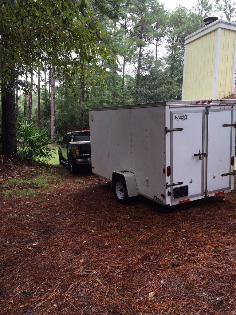

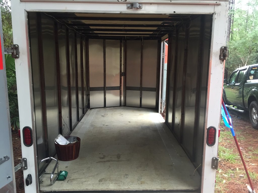

Well after a little over a month on the forum and a ton of research I'm starting my build. I bought a 6x12 small v-nose used. Got it off an older guy that used it to transport his motorcycle in, but only used it a few times. My plan is to turn it into a home for my wife and I for up to a year. We are going to take a year before we have kids to travel around the US. The tow vehicle is a Nissan Frontier 2007 V6 4x4 115xxx miles. We are in the insulation/window install stage right now. Order my windows today, 24x15 and a 30x20, should ship tomorrow. The first questions I have are about a vapor barrier and walls.... Do I need one? Does it need to be on the skin side as well as the inside side of the insulation? Has anyone tried the liquid nails method of attaching the walls to the studs?

I insulated with 1" and 1/2" rigid insulation (walls and ceiling) before reinstalling plywood walls. I didn't even consider a vapour barrier.
I installed 1 1/2" rigid insulation on the floor between 2x2 joists before I added my own 1/2" plywood floor and lino.
With the windows cracked a bit and our MaxxAir ceiling fan on low at night, we've had no problems with condensation.
NEO uses real sheet metal screws so it was very easy to remove the interior plywood walls intact. I screwed the walls back in place after insulating to my thermal break "strips" (3" wide 1/2" plywood strips on each rib), not directly to the aluminum ribs.

Ordered windows, RV latch for the door, city water hook up, 30 amp power hook up, and a hand pump sink faucet!! Nothing worse than waiting for parts..... Think Im going to forget the vapor barrier and go with the wood strips and then the walls. Thanks for the support and will post more when the parts get here.

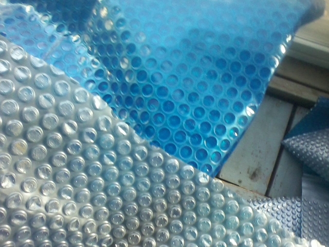

Sorry, I don't have the answer to your questions. But I have a plan, for my CT. We live in a "very cold" region. It is also a low humidity area. I have a "used" floating thermal blanket, for swimming pools. It is very similar to bubble wrap packing material, although much heavier gauge material and larger bubbles. One side is "metalized", where the bubbles protrude. The other side is smooth. ImageThe purpose is to float on the pool and "seal" in the water (evaporation) and to reflect the heat back into the pool. My plan is to place 1 layer metal/bubble side out, which will allow for some air gap/drainage in case of leaks/ moisture buildup. Then a layer of 1" foil faced foam insulation, followed by a layer of the thermal blanket, metal side facing inward, then interior siding/ceiling. I believe the screw holes will seal up as the screws tighten. Perhaps the self sealing screws used for metal roofs?
