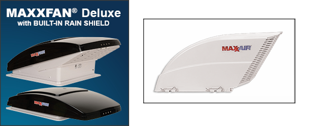

Just a suggestion for your consideration: check out the Maxxair Deluxe fan http://www.maxxair.com/products/maxxfan/maxxfan.php before you buy a Fantastic Fan (FF).
I installed a Maxxair Deluxe on my CT conversion. I like that it doesn't close when it rains (it doesn't have to - it has a built-in "rain shield"). I also like the remote control!
I did consider the Fantastic fan, but I wanted the fan to run, rain or shine. The FF does have a "rain sensor" option that costs more money. It will automatically close the fan when it senses rain. However, if you want the FF to run when it's raining, you can buy the extra-cost permanent cover - just the right height to lose thanks to that tree branch you didn't notice!!
Good luck with your selection and CT build!
PS: I am not affilitated with Maxxair company. I just think it is a better product (for my application).
