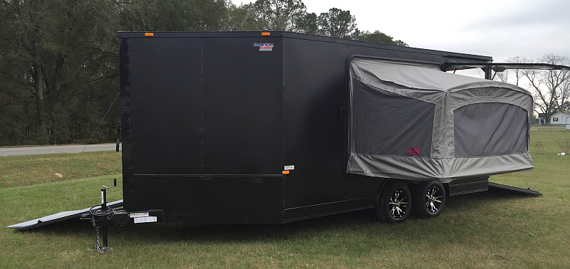

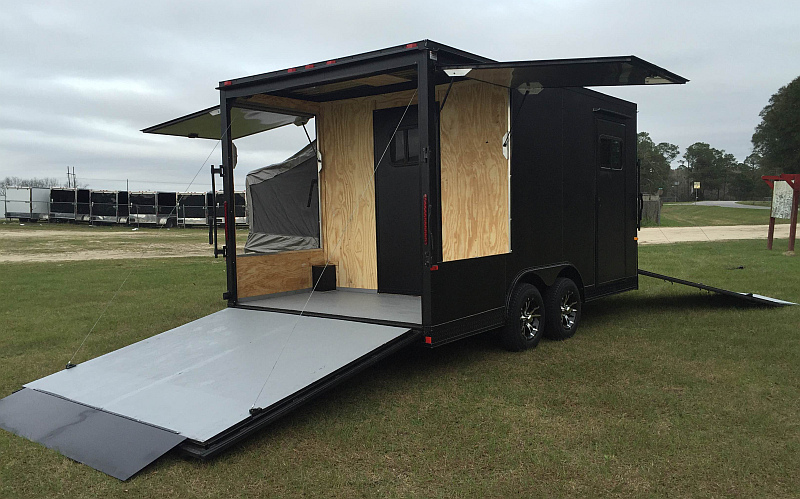

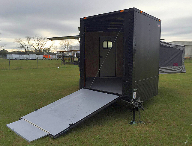

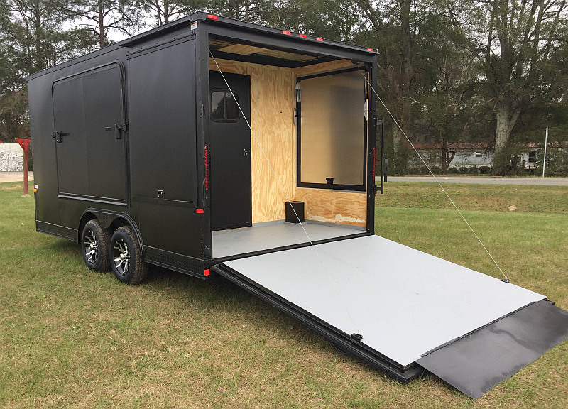

Postby Camp Wags » Sun Jan 31, 2016 5:23 pm
This is my first post after prolonged research of the site. Went down South to pick up my trailer and returned just before the Snowpocolipse hit the East coast mid January posting.php?mode=post&f=42#.
Now to plan the interior...
I will install an outdoor kitchen on the curbside gull wing opening and the roadside opening will be boxed in with an outdoor shower with a propane camping hot water heater for outdoor showers.
Remember, my first post which I am sure will get better with time.
Gary

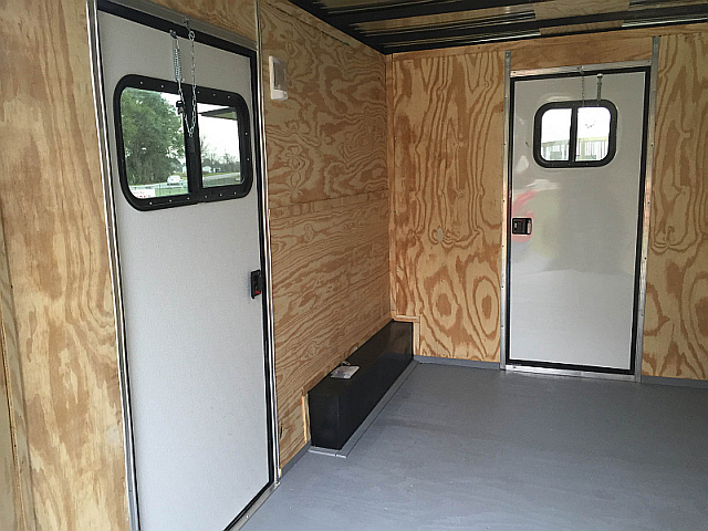

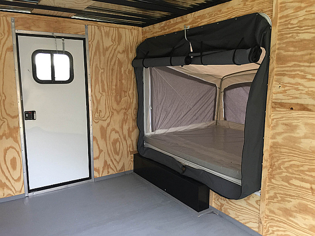

Now the inside to be planed will have an indoor shower along with a Compost Toilet like "Over the Top" has. Keep it simple grandpa would say.
I am thinking about moving the back wall back toward the fold down door freeing up more space... The original idea was to have a 4' porch but space shrinks real fast...
Also will have a U berth dinning setup for extra sleeping space and inside lounging.
Int looking rear.jpg (188.17 KiB) Viewed 5225 times
Int looking rear foldout.jpg (189.4 KiB) Viewed 5225 times
front door open.jpg (196.46 KiB) Viewed 5225 times
