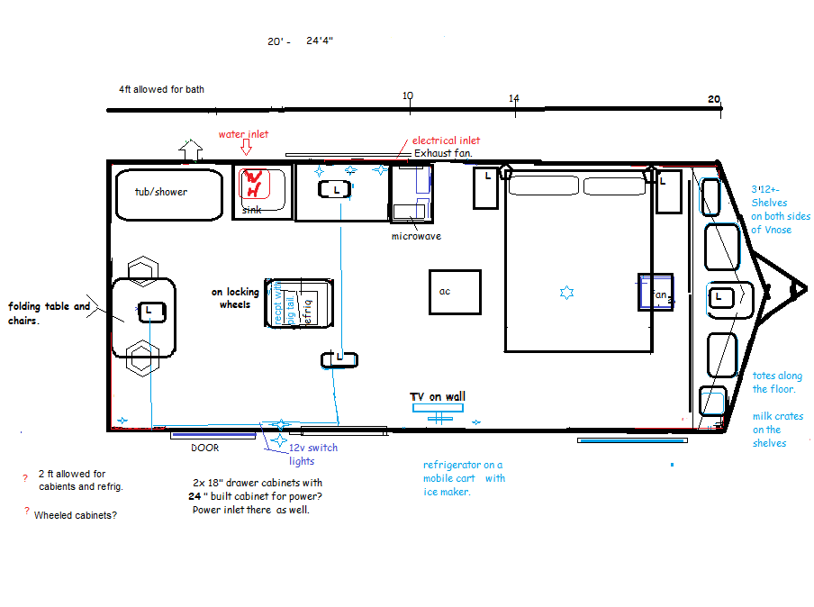

I have a trailered Bass Buggy fishing boat I plan on pushing up the backdoors and strapping down for the ride. Bed up front. Kitchen dining in center.
my Paint program CTC plan.
8.5X20 ctc.png (48.95 KiB) Viewed 44387 times

Postby lrrowe » Fri Feb 05, 2016 7:38 am
Are you concerned about what appears to be more weight on driver's side? But then again, with that size trailer, you probably have HD suspension.
Bob
lrrowe
Posts: 3285
Images: 439
Location: SW Virigina
Re: plunging on another build
Postby flboy » Fri Feb 05, 2016 7:44 am
That is a good point. One thing to consider is putting your freshwater holding tanks and batteries on the right side somehow. It would be better to have weight distributed more evenly.

Postby Wolfscout » Sat Feb 06, 2016 4:49 am
I'm not real concerned with what appears to be a balance because of the boat and trailer than I'm going to pull in from the rear and align on the curb side.
There will be some Bicycles and folding furniture gear on the right side. Refrigerator cabinet is also on the curb side. When it's all loaded up to travel, there won't be such a weight distribution issue.That's why I don't think it's going to be one-sided for towing.
BTW I'm not going to be putting in the shower anytime soon. That's for down the road when I've figured out a few more things.

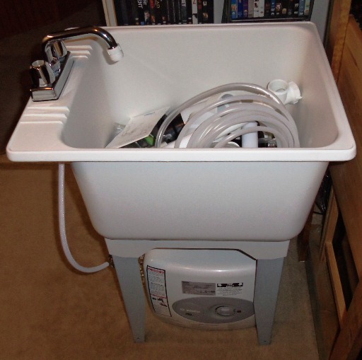

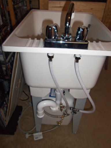

Friday and Saturday - I got in one of two windows I had ordered. 24x36. I'm all plumbed up on the sink waiting to get it in the camper and hook up the inlet and outlet.
LOL went and got the plumbing needed for the tub.
Before that I built a TV stand out of some recycled wood I had in the barn. Also used some of that wood to build a refrigerator cart and a shelf cabinet. We've decided to use big man cots this go round to hold our foam mattress. That should give us some under bed storage room as well if we need it. ( It's been on the floor the last few trips in our old CTC. at the moment, all of the cabinets that I've built for the CTC have been stained.
We decided on putting a storage closet-like area in the V-nose and using curtain panel's to separate it (for now) from the rest of the camper.
We're going to paint the "bedroom" end of the camper the same gray we painted our bedroom here at home. should make a neat area and add some curtain partitions to separate that area off as well. so it can be fully opened the entire length or closed off.
the pictures below are some that I've managed to assemble prior to the arrival of my new trailer..
right side of open shelves cabinet with WFCO 45 amp power center on right side & microwave on center shelf.
sink side view with some plumbing.
sink with water heater.

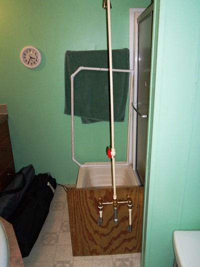

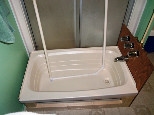

Today I spent some time building a frame for the RV 40" tub/shower I'm planning to install. The frame and a section of Plywood with stain and sealer are temporary holders for the plumbing till I figure out what I want to use for the shower surround or buy one of those expensive molded jobs. I've gotten the plumbing fixed to it's fairly simple to take apart and reassemble inside. Pics coming later. That room's a mess right now. LMAO

Here's two images of the tub/shower partially assembled in my 2nd bath now. lol
right side back view of plywood and some faucet plumbing so far.
side view of tub and frame with faucet set holder.
