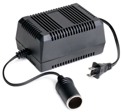

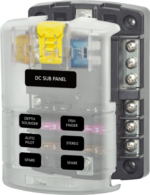

My MaxxAir fan and Sureflo water pump are 12v. They run off a RoadPro 6A converter into a BlueSea fuse block. I cut off the cigarette plug and wired 1 lead to the bottom and the other lead to the top of the fuse block.

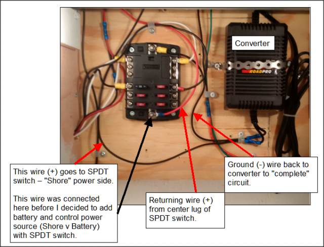

We return home unexpectedly last October, so I figured I'd use the time to add a 12v battery. I installed a SPDT switch to direct the power from either the RoadPro 12v or the battery 12v. The Roadpro 12v side of things works fine, but the battery side doesn't. Nothing, nada.
I think the reason the battery side doesn't work is because there is no ground. The switch controls where the power (+) comes from. But the "ground" from both the fan and the pump run back to the fuse block. But there is no (-) back to the battery (or ground).
I think I need a DPDT switch rather than a SPDT. With a DPDT switch, I can switch both the power (+) and the ground (-) appropriately.
Writing this entry, I think I have answered my question. But I'd still like to ask: Will a DPDT switch solve my problem? Or is there another, perhaps better way to do this?
