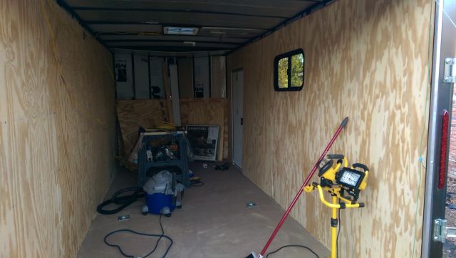

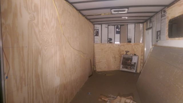

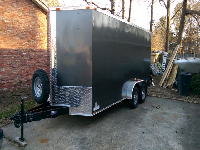

We started with a 7x16 Cynergy Caro trailer.

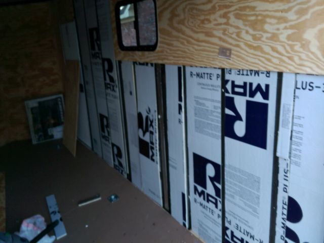

I painted the floor with a non slip textured deck paint and installed six 5000# D-rings with backing plates to secure the 4 wheeler or RoadKing depending on whats loaded, then it was on to taking down the factory installed plywood and installing the 1" thick closed cell poly insulation.
While insulating I roughed in two interior receptacles on the drivers side wall, one interior receptacle on the passenger side wall as well as three exterior receptacles. Wiring was done with 12/2 w ground romex since I had it on hand. I made a decision to change the way I rehung the plywood opting to run my seams vertical rather then horizontal for a more finished look later on.
I temporarily hung a few panels while I wait for my low voltage 12awg wire to get here and a few interior test lights before I button up the long walls for the last (hopefully) time. The ceiling came insulated from the factory but I've added an additional inch of insulation to the ceiling except in a few spots where I ran short till buying two more sheets. Next comes finishing the ceiling insulation and finished ceiling panels, running my 12V wires for the ceiling and wall lights and deciding where to put my light switches and dimmers for the LED strip lights.

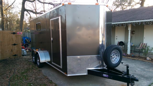

Like your progress. Did you put the window in yourself? what size is it?

chiefairwrench wrote:Like your progress. Did you put the window in yourself? what size is it?
No Chief, its one of the options I had installed from the factory when I bought it. Its a 30x15 slider. After seeing how they installed it, I wish my welding skills weren't so rusty. Eventually I'll end up installing another window or two of my own. The factory price wasn't bad ($125.00) and now in hindsight I should have had them install another one.

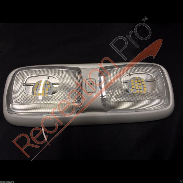

These will be installed on the ceiling, I bought one originally to test them out before buying a second, Yes they're bright, atleast to me. They're 3200K warm whites,540 Lumens

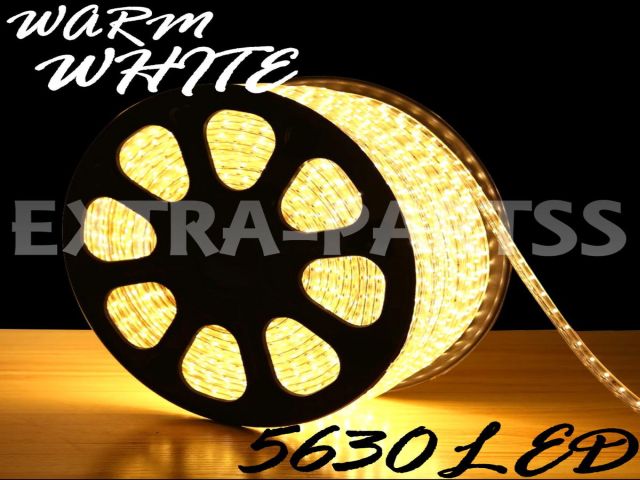

I bought two sets of these LED strips to install at the ceiling/wall edge, one on each side just a little over 16 feet long per set

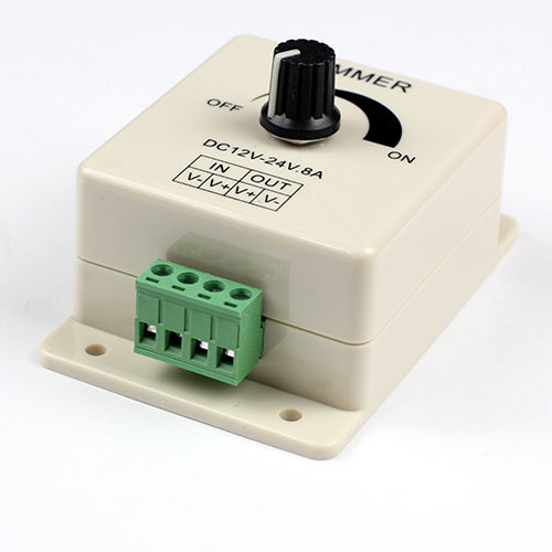

All the lights will be controlled by these dimmers
one dimmer for each set of strips and one dimmer will control the overheads. I pulled 100+ feet of 12awg wire to wire them all up. The ceiling lights share a common ground/n4egative and a common positive from the dimmer outputs. The LED strips are wired individually, on both the input and output side of the dimmers.
