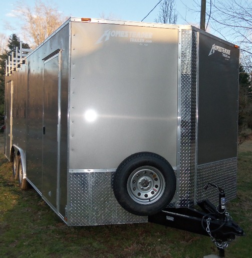

Mine was mounted there at the factory. I don't know what it goes through, or into, but its sturdy. How sturdy? I had an Antelope run right into it running at full speed, while I was doing about 60, and the tire is still there! :shock: Oh, it knocked the hell out of the trailer, bent the framework a little, and left a slight indentation, but I pounded it out, and am still going. No leaks, no loose tire, just some "personality" there now. ;) A reminder of how I hate deer, antelope, elk, moose, and other 4-legged animals when they cross roads. And the bastards far outnumber humans where I live and play! :x In hindsight, I think the best place for a spare would probably be on the back door due to aerodynamics and space, but the front vee is solid on mine. These are before the collision.

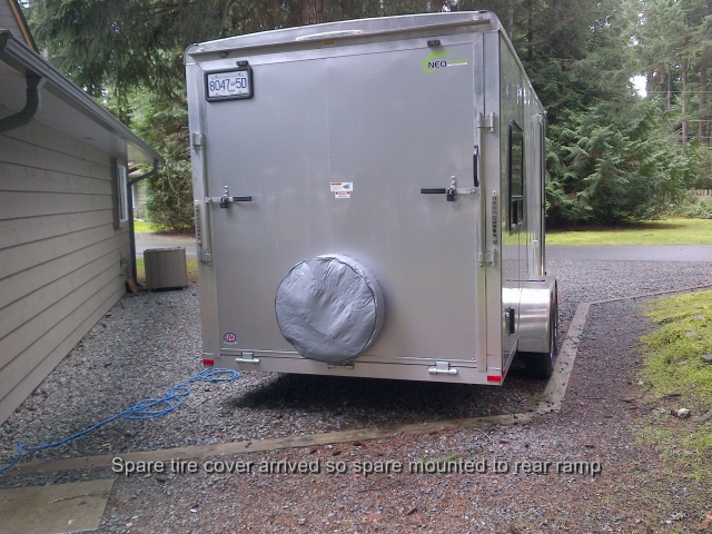

I know I am not answering your question, but I mounted my spare on the rear ramp through the center framing with 2 of the "single-mount" bolts that the trailer came with. The spare was originally mounted high and inside the trailer on one mounting "bolt". Here is a link to the device: http://www.textrail.com/LOAD-LOCKER-SPARE-TIRE-MOUNT/
I contacted the mfr to ask if one mount was sufficient if I wanted to mount the spare on the outside. I was told yes it was, but just to be on the safe side, I ordered a second so our spare is mounted with 2 bolts, again, through the aluminum framing, not just the plywood (I wouldn't trust the plywood alone to hold the weight over time).
We've done over 10,000 km (6,200 miles) with no problem. Hitting the spare with my clenched fist is part of my walk-around check routine before we leave a campsite.
