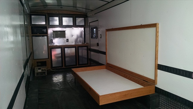

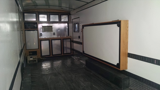

For my 6x14, I went with two fold ups, one 30 by 72 and and the other 30 by 76 in twins.
I wanted a small walkway between them for my wife's night trips.
You can see some of the work in my thread below. I am further along on them now and will post new photos soon.
Bob
