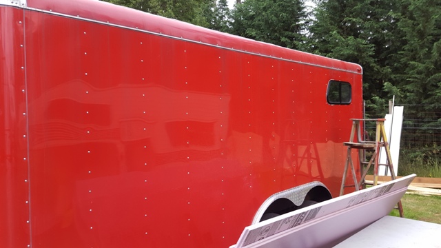

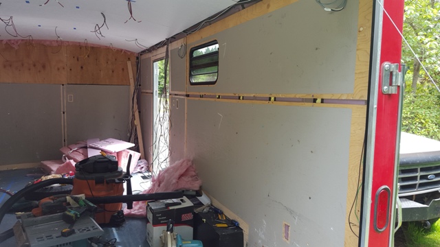

Thought i should post up my project of my 8.5 x 16 conversion.
Being an Electrician means a lot of lighting.
Hopefully the pics work and i will add the others.
Outside after small window install
Inside after insulation

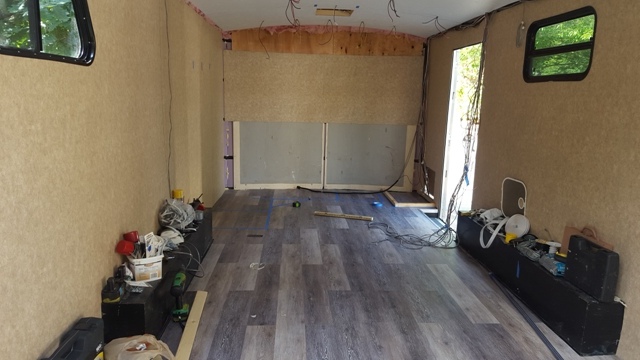

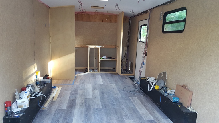

Postby cdub » Wed Jul 13, 2016 9:43 pm
Flooring went in easy, Vinyl planks very quick but have definitely learned that when they say let the floor float they mean it. In the sun the floor expands and lifts then goes back down when it cools.
The cabinets were a bit nerve racking as i have always bought boxes in the past for the house but i didnt want mdf board cabinets that would expand from the damp BC weather.
Floor Installed

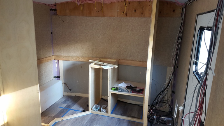

Postby cdub » Thu Jul 14, 2016 9:07 pm
The photos show right side up when i view.
The wall panels are rv wall panels. I liked the appearance of these but they are an MDF product and we had a water issue with the windows and ended up replacing the rear panels with a luan panel style.
Cabinets are not my skill set so i was concerned about making them and having the inside look mickey mouse. They went together OK but had a couple of difficulties, mainly as the walls and ceiling are nor a flat and square surface to measure from.
Cabinet Build.jpg (141.51 KiB) Viewed 4933 times

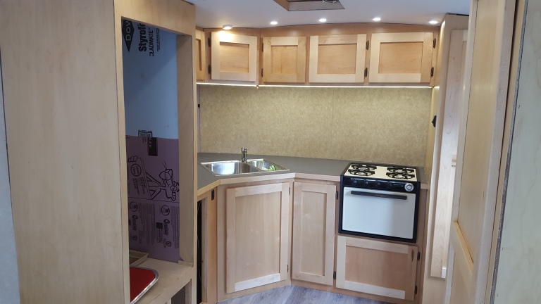

Postby cdub » Sun Jul 17, 2016 11:00 am
Cabinets are looking better than i though, only a few issues with fit from not being perfectly square and flat. The stove is a donor from a demo camper that we sanded og the rusted chrome and painted black. The sink is an Ikea 1 1/2 with cold water only. I have the pump from the donor and added a small pressure tank to steady the water flow. I still have to plumb the water lines and install the water tank under ther trailer. I have a 30 gal tank to go between the axles. i also have a 20 gal grey tank that was the fresh tank from the donor that is fitted under the sink counter.
installing the counter top although a challenge to cut and fit the plywood turned out well once i routered the laminate. The face is a 1/2 by 2 maple. All the cabinets and doors are maple.
Stove in
Stove in.jpg (117 KiB) Viewed 4861 times
