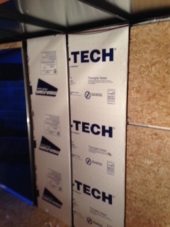

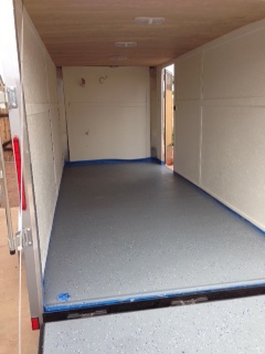

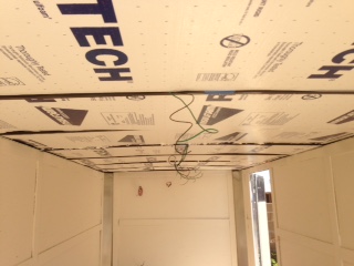

I purchased a LOOK trailer about 4 months ago, planning to make the trailer into a bit of a toy hauler. No shower or toilet in the plans, but a comfy place to sleep on hunting trips. Being in Arizona, AC will be a must. I started with 1" board insulation and paint. Added a thin wood ceiling, and rv style lights prewired into the ceiling and walls.

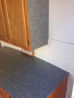

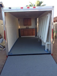

I have been working on this for a couple months now.... I built a murphey style folding queen sized bed. It is wide enough to fit a 6" thick mattress available on amazon. I also scored some free cabinets and shelves. Painted the countertop to match the floor. Up next rv power converter install plus a 30 amp power inlet. Still up in the air between a WFCO converter or a PD but i will have to pull the trigger soon. AC and windows after that...once funds become available haha.
