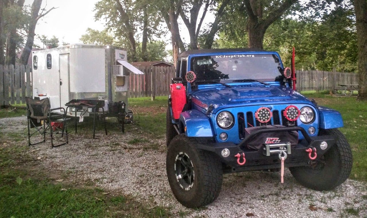

I'm using a 8000 BTU window unit thats energy star rated in my 7x16. It pulls a whopping 5.4A @ 115v and will easily run from a small generator.
144337
It will eventually go here in the ramp once I finish the support rack. A flap door will cover the hole when not in use.
