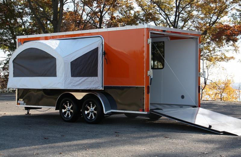

I am still trying to design my CTC in my head :thinking: and need some experienced advice. I will be using my CTC strictly for camping only so I am thinking I can cut cost of an 8 ft. x 18 ft. trailer to maybe an 8 ft. x 14 ft. if I can come up with my design. What I'm thinking is purchasing my trailer with a rear ramp instead of barn doors. When I lower the ramp I would like to use it as an expandable room/ bedroom. This would involve having some type of frame work made along with a RV style material made to go over the frame. This would seal around the ramp door and back of the trailer making it weather proof and would be similar to a pop up camper. I would then use the room mainly for sleeping quarters opening up the main body of trailer for relaxing and cooking on days when weather would force us inside. Any one know of a company that could make something like this or your thoughts? If anyone has drawing ability maybe you could throw a sketch up here of my idea or let me know how to post my own sketch.

Have you seen these for Cargo trailers? It is a pop out bed that will free up the inside.
http://www.mirageinc.com/bed-door-46-34 ... d-out-tent

WOW what great responses! OP827 that is pretty cool but may be difficult to build just a section of it. But will keep it in mind. Thanks!
Padilen: I have considered the slide out room using foam and canvas still under consideration. Thanks!
flboy: That is exactly what I have been looking for. This was not available when I started visualizing my CTC. Thanks!
McDave: I will be watching for your message. I am in North Carolina so working that project together would be rough unless you wanted to vacation in NC for a week or two...Lol You can also contact me at [email protected]
Ya'all ROCK and thank you for the suggestions. I feel as more and more people convert these trailers the customization ideas will become more and more available. Especially custom items like the pop-out bunk flboy posted.

Postby beachguy005 » Sun Feb 12, 2017 8:06 am
I'm working on a smaller 5x12x5 and it's been something I've been thinking about for when I'm out for extended periods of time. One of the things I've considered is this type of SUV tent connected to my barn doors. Plenty of extra space and a screen room too.
https://us.napieroutdoors.com/store/cat ... duct_id:4/
