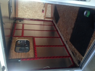

I have a two Tone trailer. Black on the back silver on the front with a chrome slash. Here's a picture from my phone album. I installed my 15 x 30 windows in the black section and put them so that I could see out when I was standing up inside the trailer but hopefully nobody could see in. Image

The front of my trailer is basically kitchen. So those two windows are just above counter height. The wall stud spacing determined their lateral locations, and then the upper cabinet design.
