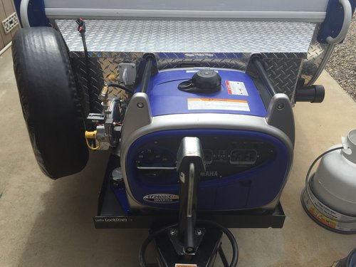

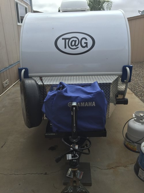

1) Put it in the bed of a pickup inside a protective box like the picture below. Problem is, I don't have a pickup.
2) Mount it on the trailer tongue in a protective box like the picture below. Most trailers I've seen don't look like they have enough room for this, but I have seen some trailers that offer optional longer tongues.

Put mine on the tongue in a locking mount, nice and safe.
2015 T@G Max
2015 Toyota Tacoma TRD Sport 4 Door Short Bed
