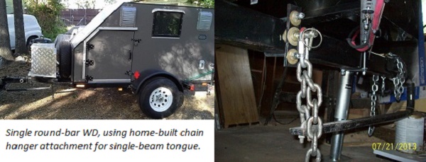

My trailer is short and heavy, at 12' (a 4x8 cabin) and about 1700 lbs. I built it aiming for 1000lbs, to be towed by my HHR Panel, and later by a Jeep (or similar 4WD). As it turned out, I have to tow it with my 2500 HD Chevy, which I had previously equipped with coil-over booster springs, and a WD hitch system (1000lb round-bar), used to tow our 24 ft long travel trailer or (mainly) my dove-tail, all steel car hauler (which is overbuilt, previously hauled a Bobcat loader). I used that trailer to haul various loads, mainly cars or trucks, usually my Chevelle dragracing car. I bought the WD hitch after one trip, hauling my racecar with my older '69 Chevy C-10; the trailer was wagging the truck around so much that I slowed to 55 mph most of the 600 mile trip (my normal is 75). The addition of the WD system tamed that loose control. I later transferred the WD to the heavier, more capable 2500HD, which is taller, so I've used it having to pull my trailers at a slightly nose-up attitude. I tow my smaller (comparatively) TTT the same way, using only the right-side round-bar and a fabricated adapter to connect it to my single-beam trailer tongue.
single-bar WD.jpg (67.79 KiB) Viewed 4096 times
I don't use a sway control on it, yet, because I haven't encountered any sway. When and if I ever get the 4WD I want, then I'll adapt my WD system to it. I have towed the TTT once, without using the WD (single bar) set-up, and did encounter some bucking over some roads; made me decide not to do that again. What I use the WD for is to mainly make sure the coupler has plenty of downforce on the ball, to minimize flex at that point, and to remain "on the ball" even if the coupler loses its' grip (hd that happen once, before using WD). A WD system is worth it, IMHO, just for that reason. But, if you just need sway control alone, kits are available and hitch adapters, also.
