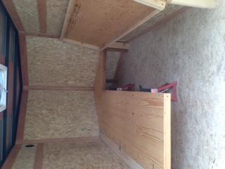

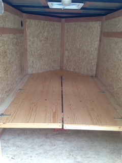

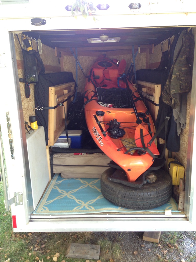

this is how i set my bed up, it gives me the option to use one side as a bench, or as a full width bunk that folds back so i can fit the kayak and all of my camping gear.

This looks awesome, if only I had that kind of space, I'm going more overland and building out the back of my truck. What did you use for the actual sleeping pad?

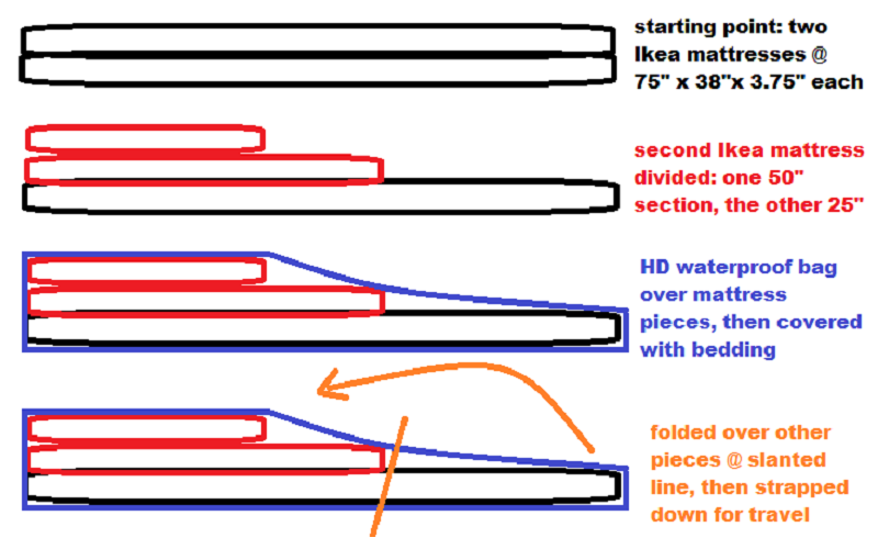

  • I don't have a cargo conversion, but I do haul cargo in the front of y 4'x8' TTT. I started doing this before I had a large tongue-box to hold enough equipment (including battery) to shift my trailer's weight bias forward (I needed more weight forward to have sufficient tongue weight for travel). I installed an e-track on the inside front wall, and D-rings on door frames and on the floor, as well, to strap the cargo down. I folded my mattress back over itself, strapped it down, and put my cargo in.
  • At first, the cargo was usually one 65-75 lb ice chest (loaded), and two seven-gallon Aquatainers (120 lbs for the pair), strapped to the front e-track, and with bungees to the D-rings holding them down. Plenty of tongue weight now! later, as I got the balance to where I wanted it, I could travel without forward cargo in the cabin, but I still carry one ice chest there, to keep it cooler than in my truck bed, in the sun.
  • 107316107315107314
  • But, I have a problem folding the mattress back to make room for the cargo, after I bought a second 75"x38"x3.75" thick Ikea mattress to put on top of the original. I didn't need it, but my wife said she did (she never has used the trailer, yet). So, I'm going to cut the second foam mattress into two sections, to ride on top of the bottom mattress. Then, I can still easily fold back the single thickness mattress, on the bottom, and strap it down for cargo room. By stacking the cut pieces on top of the intact mattress, I can also sleep in a more head-up position, that I prefer, due to periodic acid reflux, and be able to recline, if I just want to relax during a hot day, having no other airconditioning outside (Texas heat, even in fall and spring). I may have to trim a little extra off of the cut portion of each piece, to make a smoother transition to the next layer, and I'll have to secure all pieces in place with zip-ties on the side edging (my all-purpose solution). A commercial, 5 mil thick, heavy-duty waterproof bag (I had a mis-placed canopy direct water thru an unsealed door one time, my waterproof bag saved my mattresses!) will cover all. The existing bedding will still fit, as it's oversized, and the excess will work for the new upper layer.
    modified double-mattress plan.png (92.03 KiB) Viewed 2123 times
  • It may be unorthodox, and a redneck solution to two problems, but I always defer to function over form anyway.
