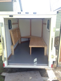

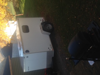

so i went out and bought a 5x8 v-nosed cargo trailer with the intent of converting it to a camper. the plan is to be able to use it as a camper that can be easily stripped out and used for hauling materials and for storing all of our camping gear. i'm going to keep the build fairly simple and so far have a roof vent, 2 side slider windows, an rv door latch, a full width bunk that folds up out of the way, insulation and wiring for lights.
we used it all of last season and pretty much have the interior tweaked to the way we like it so it's ready for paint once the weather warms up enough.

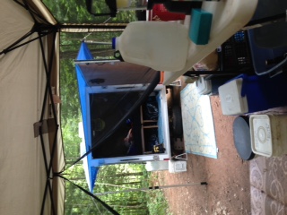

we have a large dining tent that makes up for the lack of elbow room in the tin-tent because we had to trade off cubic footage for towability. the trailer's dry weight is 700lbs with 100lb tongue weight and tows very well behind my tj, in fact it stabilizes the heep very nicely at highway speeds, kind of like flights on an arrow i guess. more later....

it finally got warm enough out so i painted the interior, got most of the trim back in and started to reassemple the bunks which i decided not to paint them because i liked the smell of the cedar and it was less work too, lol. i still have to panel and paint the ceiling, install the strip lighting, solder the factory wire connections (i don't trust those tap-in connectors) etc. will post up as work progresses.

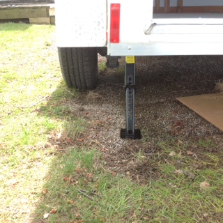

i've been busy getting the jeep ready for our first trail run of the year next month but i did manage to get the stab jacks installed yesterday, better than messing with jack stands
