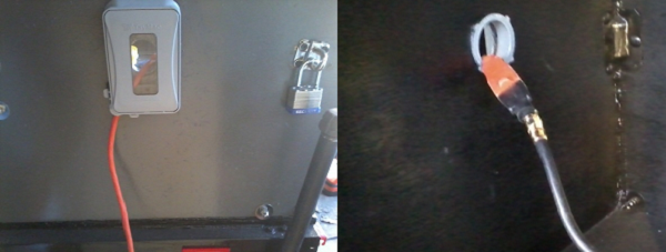

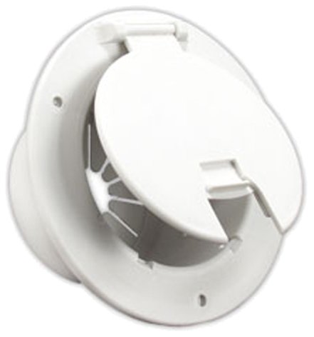

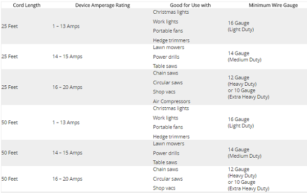

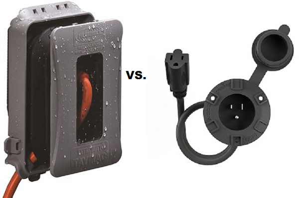

Why get two? If you're going to use a 120vac extension cord to furnish you with outside power, why get two Noco plug sets, when you can use just one Taymac Weatherproof when-in-use expandable entry port cover. I use a single 120vac extension cord (either a 16 gauge or 14 gauge) because of my low power requirements (my A/C runs at <5 amps), run thru my galley wall. I keeps the cord end completely dry, even under monsoon conditions (Beaver's Bend '15), and can even seal when I used it for two cords at a time (one in, and one out). I bought mine for under $8 at Home Depot.

I did think about going to Home Depot and picking up a home outside waterproof unit but the ones I saw were all designed to have me plugging a male into the side of the trailer which can be dangerous as that would be 2 males on the extension cord (one to the trailer and the other to the 30amp plug). Is there an alternative home unit that has the male attached to the outside unit of the trailer just like the expensive twist lock ones. Or maybe I should just swallow my Scottish pride and buy the twist lock ones.

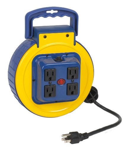

Another way to do it is to put this cheap access panel into the floor under a cabinet or etc. and just run extension cord(s). I'd recommend buying a cord on a reel with a built in 20A or 15A breaker so you protect against overloading. That is very important because you never know what someone may plug in and electrical safety is important. When you get ready to wire it all up permanently, then you can decide what you need and drill holes in the sides. This is what I did with my first CTC and it worked great. At the end of the day, you will have a good reeled extension cord when not using for camping and the access panel is less then $10.00. Mounting this access under the trailer keeps the rain out when using it .. just put it close to an edge where you can just feel for and grab the cord to pull through.
Just a side note... this access panel is also useful if you are in a place where you can divert a little gray water from the sink... :-) A good use for it after you wire up permanently. Just sayin!

You can get a " flanged inlet " which is a recessed male plug similar to the male part of the one in your first post link. These are available in different amperage and voltage combinations as well as straight or twist lock. Some have a weatherproof cover as part of the assembly others sell a separate cover.
A " Nema 5-15 " is the 15amp 125 volt AC straight blade unit. It is made by various manufactures.
Some part numbers are common to diffent manufacters, a WP1 is the number of the separate WP cover.
Edit: I couldn't remember the inlet number..... 5278 is the generic number. Eaton, Hubbell & Leviton use this number, they may add a suffix to denote options.
