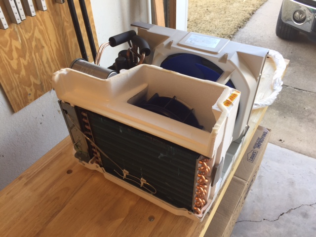

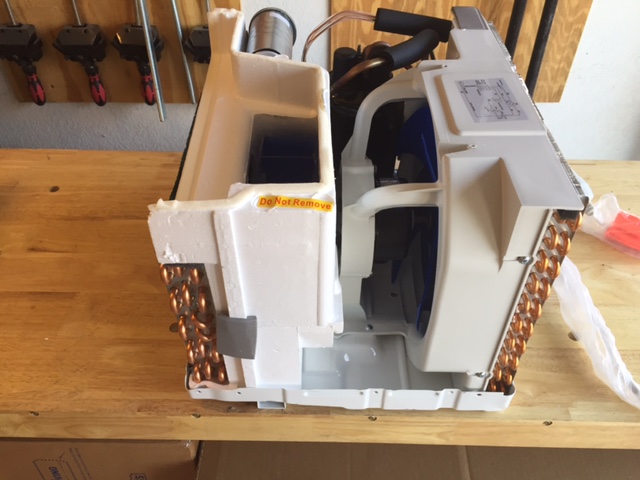

In a window unit there are two separate air flow paths. Both air flow paths need to be maintained and separated.
On the "outside" air flow path, air enters the unit from the louvered sides and/or top, flows through the fan, across the condenser coil to extract heat from the compressed coolant, and out the back of the window unit.
On the inside air flow path, (return) air enters the lower louvered portion of the front of the unit, (usually) flows through a filter, across the evaporator coil to cool the air and extract moisture (condensate), through the fan, and out the vents (supply air).
As I noted in a prior post, I am in the process of "hacking" a 5000 Btuh Frigidaire window unit. Here are some pictures with the case removed.
In this picture, the back or outside part of the unit is on the right side of the picture. The front or inside part of the unit is on the left side of the picture. You can see the Styrofoam divider that separates the two air flow paths. For the outside air flow path, outside air enters through the top and side louvers near the middle of the unit, between the right side of the Styrofoam divider and the fan, goes through the fan, and then is pushed across the coils and back to the outside.
This picture shows the inside part of the unit. For the inside air flow path, air enters at the coil (after going through a filter - not shown), is "sucked" by the fan in the Styrofoam pocket through the coil, is cooled, and then is pushed out the top fan and forward through the front of the unit.

Postby Aguyfromohio » Thu Mar 16, 2017 11:06 am
Thanks again, aggie79, that looks like the very same unit we bought a pair of.
I assume:
- cold condenser water from the cold end (inside end) runs down the sloping metal case to the hot (outside) fan
- the bottom rim of the fan picks up the water and slings is out in the exhaust air flow, impinging the hot side heat exchanger fins
- you plan to build a little dam uphill from the hot fan to stop the water being picked up
- you'll drill a hole for a water drain tube near that dam.
We talked over what we'll do with our units, and decided not to modify them.
Instead we'll waterproof the entire inside of the exhaust plenums we've built with the spray rubber advertised on TV.
We expect that most of the water will get carried out in the hot air as little droplets, and whatever doesn't will dribble down the plenum walls and run out the 3 inch screened holes we have cut through the floor, onto the ground under the trailer.
Now that we understand how this air conditioner works, we'll be sure to waterproof and seal the joints and cracks, especially at our 3 inch exit holes, so the liquid water doesn't leak out into the galley floor and cause troubles.
We hope to avoid another of those frustrating moments where we are looking at a mess asking ourselves "where is all this water coming from?"
