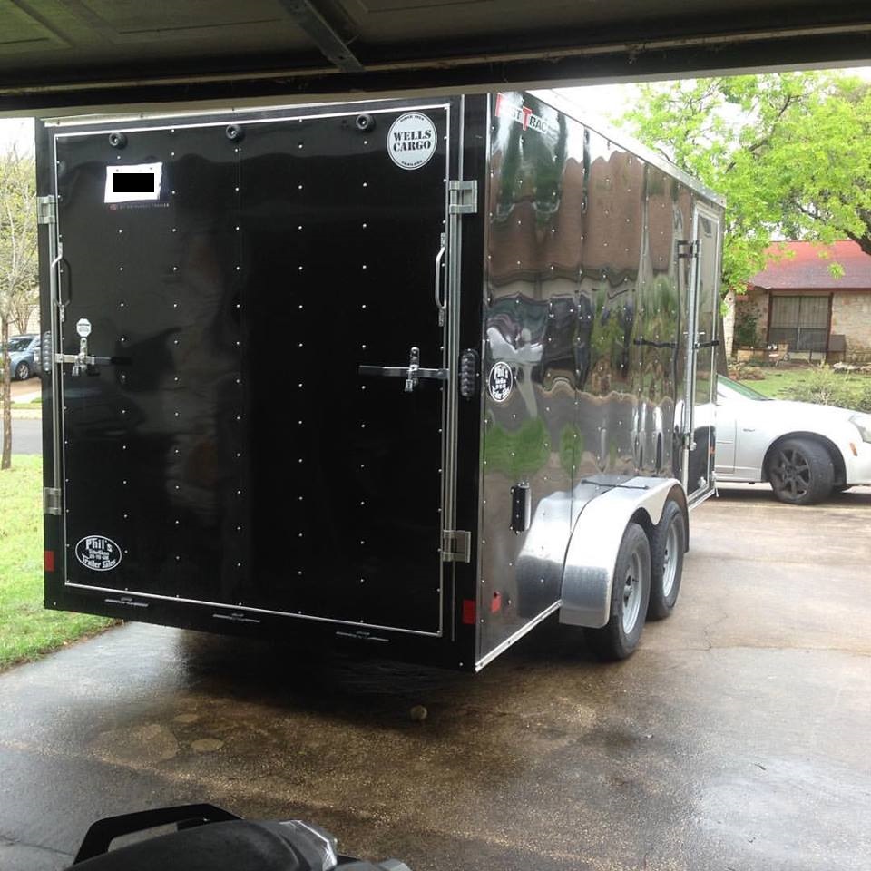

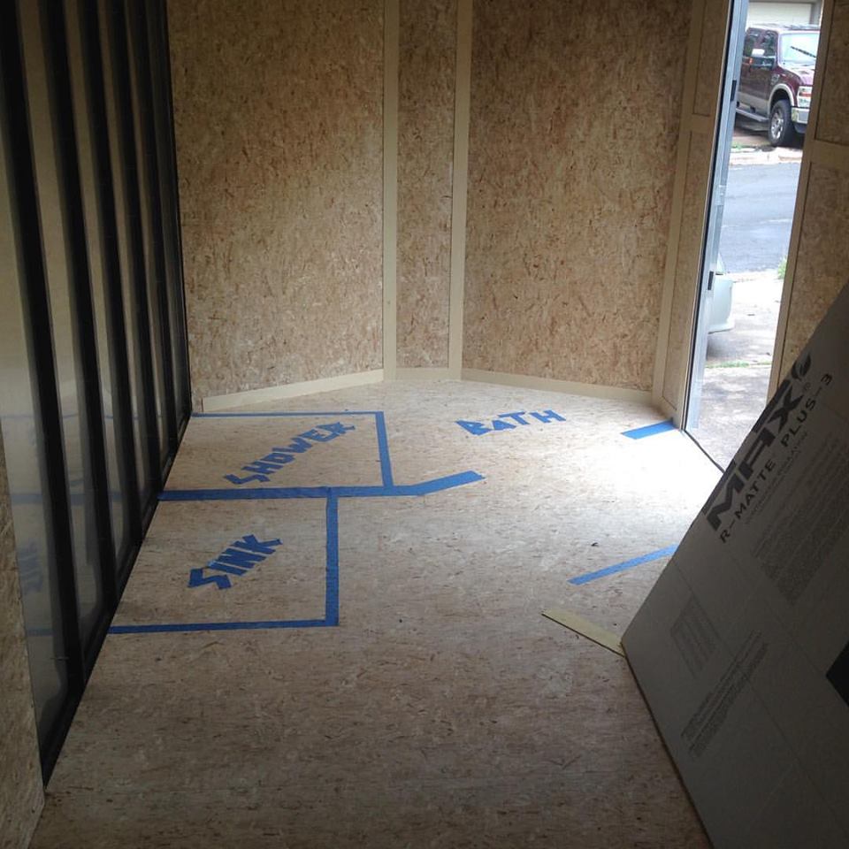

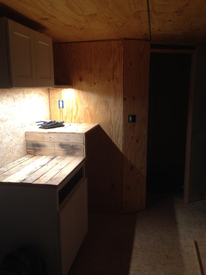

Picked this up a couple weeks ago. Needed something to stay in for out of town work that I can haul my motorcycle in as well. I'm trying to make it as comfortable as I realistically can as I will be spending quite a bit of time in it. I started up front and am working my way towards the back as far as the build goes. I'm focusing on the necessities first since I'm on a short time table. So far I've got majority of it insulated, bathroom wall up, electrical in and started on the kitchen the other day.

Welcome. I like what I'm seeing so far. Blue tape on floor is always a good place to start.
