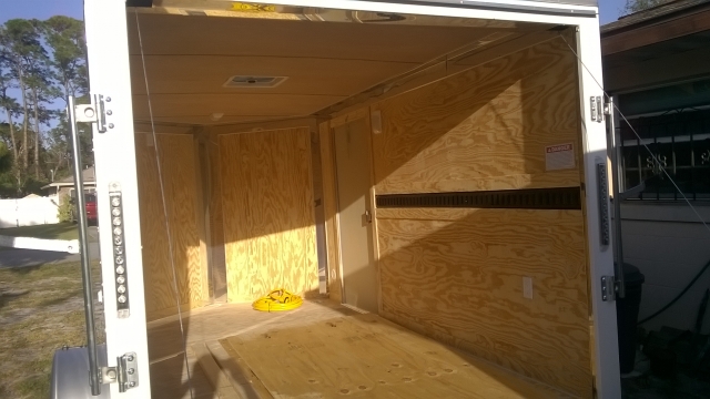

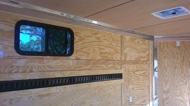

We had them put the window as high as possible, haven't measured it but it's a standard height. Not at all happy with the "recessed" e track the factory did though. There is no back plate, leaving only the thin aluminum skin behind it. Sorta ruins the already minimal insulation the plywood provided. I wish we had installed it ourselves. Really like the unexpected chrome trim inside though...

Thinking about using spray Great Stuff foam insulation for filling the gap in the e track. Anyone use this stuff? Seems like a reasonable solution.

I have used a lot of spray foam, and it does a good job of sealing air leaks, permanently. Some was Great Stuff and some was only Good Stuff. If you are only wanting a cosmetic improvement I would look for another solution. This stuff is messy and hard to control and will permanently stick to just about anything it contacts, clothes, skin, metal, wood etc. It is made to fill gaps and expands and dries, then you cut off the excess. There are a couple different types, minimum expansion, double and triple expanding. I think it would make a mess of your e-track that would be impossible to clean up, and fill all the slots, making them hard or impossible to use, and permanently adhere the track to the trailer skin. It could also over expand and bend and warp track and trailer side.
I assume there is no insulation in the walls, so you may want to consider that upgrade and then you can address the track issue at the same time. If you plan to do any camping in there it really helps. These trailers can get REALLY hot and REALLY cold, in the same day! It's a job to do, but you will notice almost everybody does that as the first upgrade. It helps with the noise as well.

Thanks for the input Mcdave. I the e track is welded to the frame so removing it isn't an option. Also we really are trying to avoid removing the plywood as the factory did such a nice job with the ceiling and the chrome trim. I just KNOW I would jack that all up! I will stew on it some more and keep looking for a solution.

Thanks Hank! I was wondering if it would be as simple as pulling off the lower panels and sliding some board insulation up though the ribs. Since the e track is welded to them it should slide up behind the track... ?

Well McDave, it's SUPPOSED to be. I won't know until I get the panels off though. Thinking that may be the best solution and I think I can just slide the insulation up under the track.
