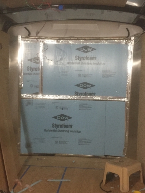

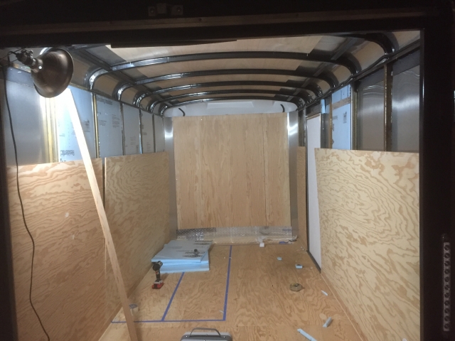

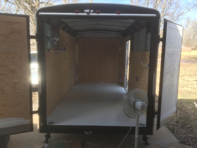

I forgot to take a "before" photo of the inside, since I wanted to get started as soon as possible. Here's the closest thing I have (after taking down a section of plywood and taping off furniture dimensions)
The first night after work, I got 5 pieces of insulation in, and was thinking it'd go quickly
A week or two of battling Murphy's Law proved that wrong

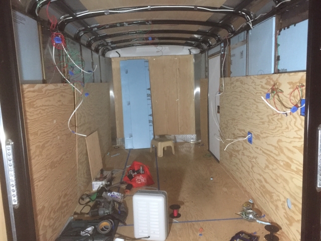

Postby rxberg » Mon Apr 03, 2017 4:07 pm
I got some help from the wife on Sunday, so I took a break from insulating to run some wire and put in some electrical boxes
Then straight back to insulating

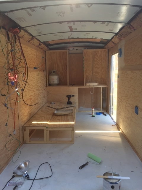

February 4th & 5th
Postby rxberg » Mon Apr 03, 2017 4:58 pm

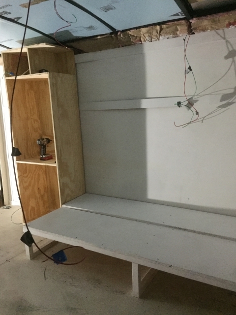

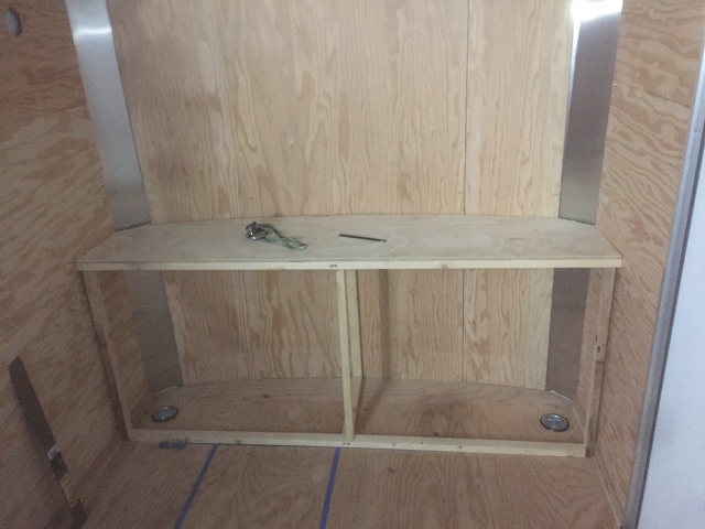

Tired of insulating, I decided to work on the front cabinet to try to figure out how to make it work.
The next day I started working on the bed and bench combo. We decided to make a murphy bed and to use the plywood base as the back to a bench when the bed is up. Here is where the bed will rest in the up position and the bench. The top of the bench will have removable cushions and will function as support for the bed when it is down. (which is why the bench is 3/4" shorter than the bed platform) We will also be using the area under the bench for storage.
In between helping me with the bench, my wife put a coat of primer on the floor.

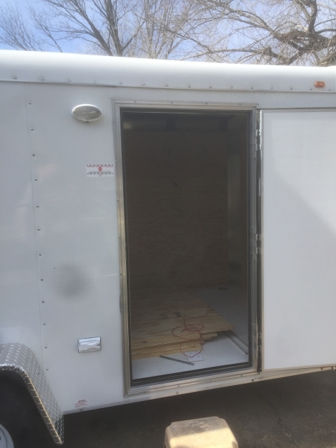

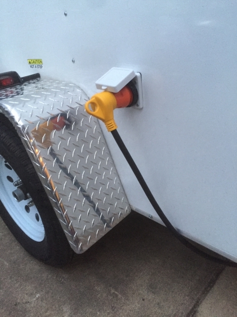

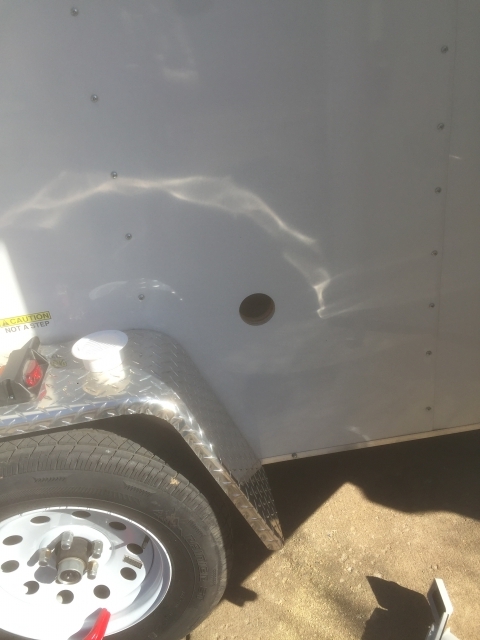

Another day off gave me a chance to cut some holes in the trailer. I'd been putting this off because it's a little disconcerting cutting holes in a new trailer you just bought. Oh well - onward. I installed the exterior outlet and the porch light (disregard the smudges- I need to replace my phone camera lens)
then went to the other side and cut a hole for the 30A plug

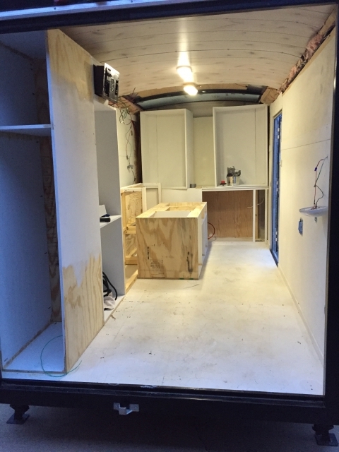

Postby rxberg » Mon Apr 03, 2017 8:04 pm
While Lynne spent some time priming everything, I started on the cabinet that will house our electrical power center, this air conditioner, and I dunno...probably towels? After much assistance getting it glued and screwed, this is what we ended up with:

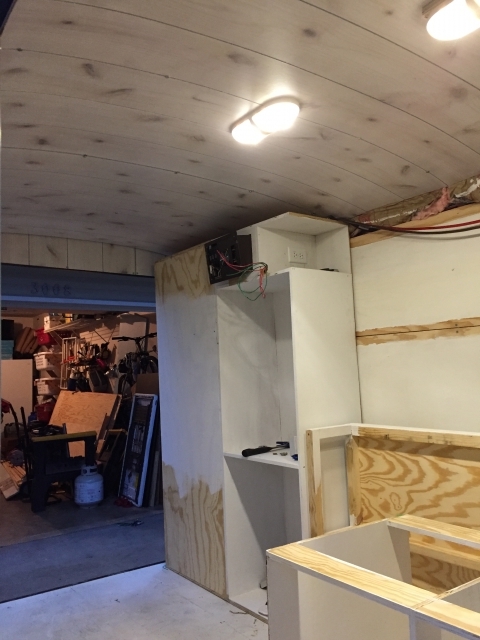

February 24th

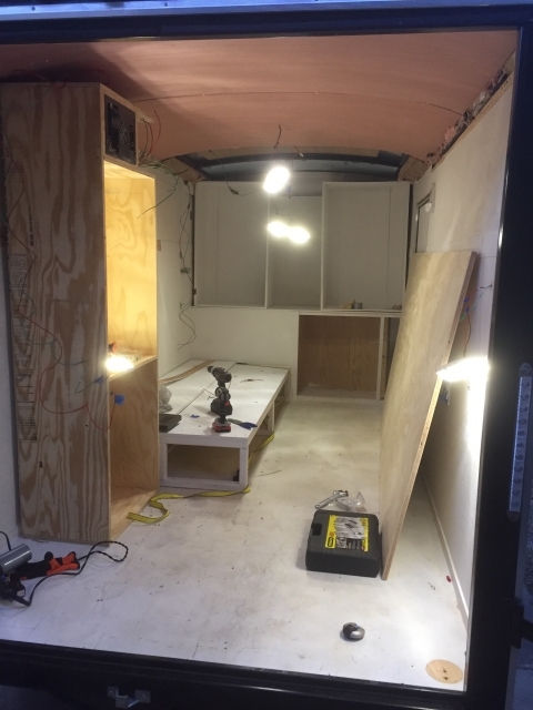

Postby rxberg » Mon Apr 03, 2017 8:16 pm

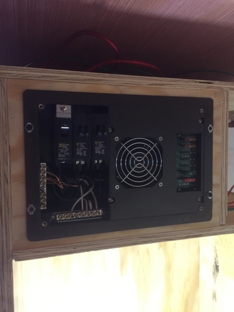

With my power center cabinet in place, it was finally time to bring some life to this trailer. I spent the morning stripping wire and hooking up breakers and fuses. Image
It's ALIVE!
and you might also notice in the above photo that I spent an hour or two installing a couple ceiling panels. I don't really want to talk about that right now...

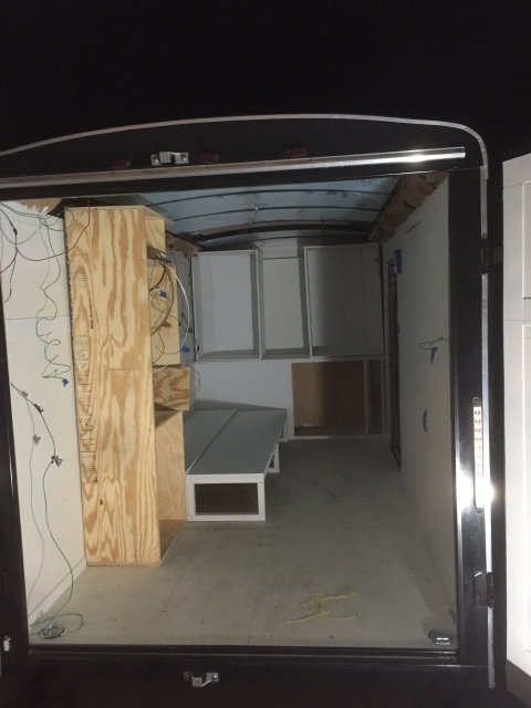

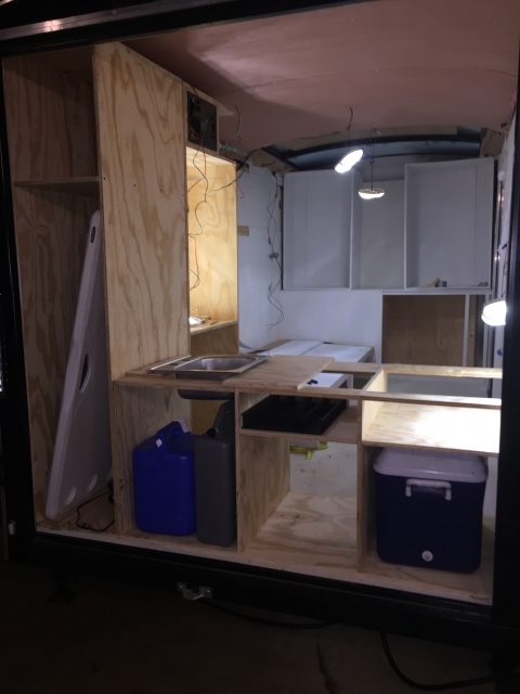

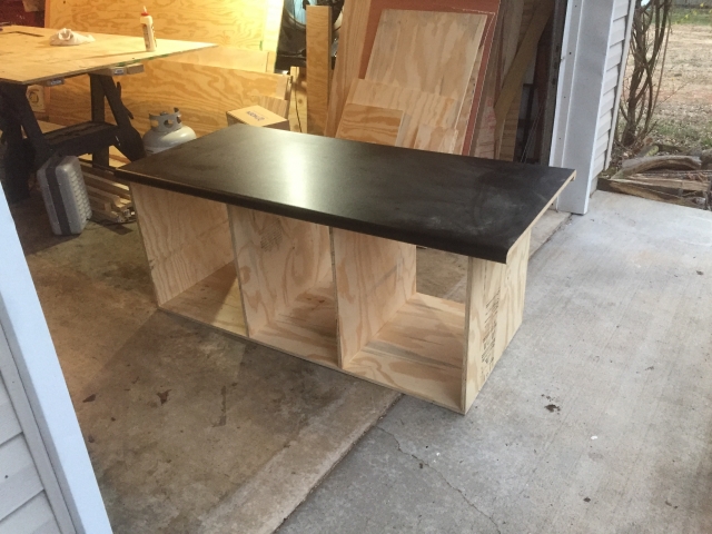

Apparently I worked on the trailer for a day or two and was too tired to take pictures. We built a cabinet for the back for my tailgating table and various camping gear and attached it to the power center cabinet with some pocket holes.

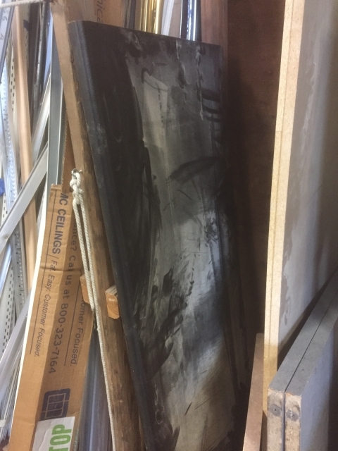

Next up, we decided to tackle the kitchen cabinets. I would love to have been able to buy some cabinets, but since we really want to be able to use the counter from both the inside and outside, everything was much too tall. We built them around 2ft tall, which gives a counter from the outside (on level ground) a height of about 41". We plan on kneeling or sitting on the bench to use the kitchen from the inside for the few times we stealth camp in a parking lot overnight.
We finally agreed on version 27.1.1 of kitchen cabinet design and got to work. We found this countertop at our local Habitat for Humanity Restore and picked it up for a luxuriously priced $8. They even threw in the dust for free
We put the cabinet in the trailer (which was quite the ordeal) and set it up like we are planning to use it to make sure everything fits and looks ok.

Postby rxberg » Mon Apr 03, 2017 9:26 pm
Since Lynne didn't love the way the ceiling boards looked and since I admit the installation wasn't my best work, I took them back out and we made a run to the local big box store to find something else to use. We settled on some paneling, and also picked up some different screws to complete the look.
She liked the look much better, and I'll admit that the result was worth the extra effort.

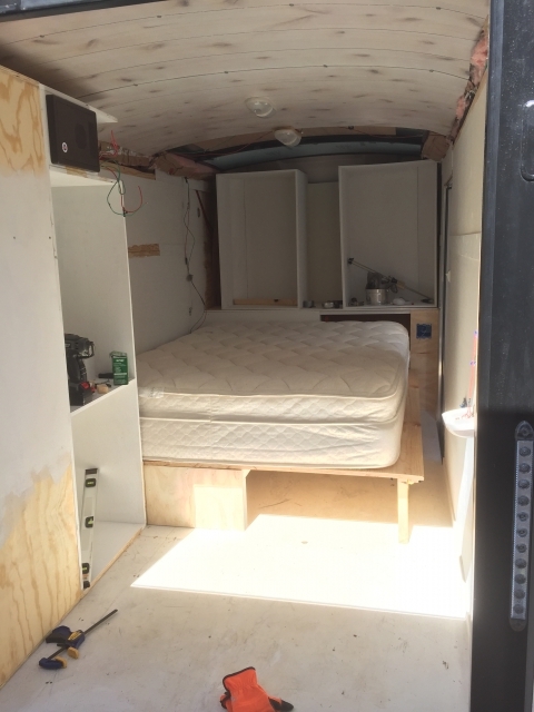

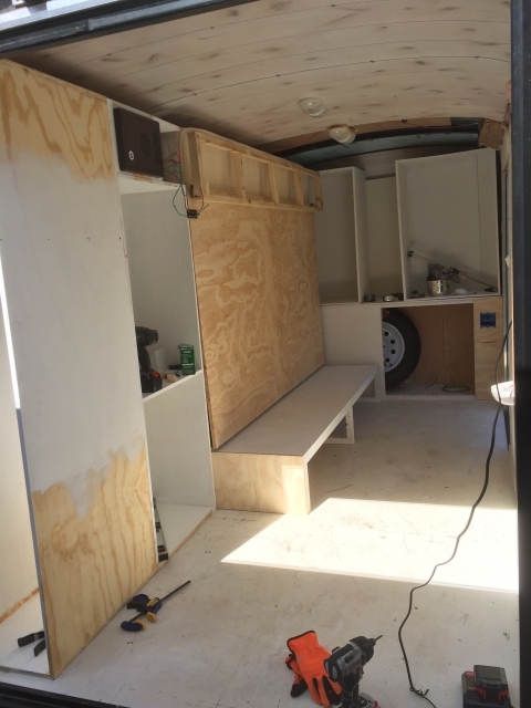

With a trip to my parents' coming up, we figured it would be a perfect time to bring the trailer and try it out for a couple nights while it was still cold enough to test the propane and electric heat. That being said, we had a few things to get done before the trailer was usable, so I spent a couple days off getting as much done as possible.
I attached the 3/4" sheet of plywood to the bench we made with three heavy duty hinges then installed the leg and leg bracket. I used a couple click into place table leg brackets that seem to work pretty well.
With a Herculean effort I probably couldn't replicate, I carried the mattress from our shed out back around the house and put it in the trailer. And then I rested..and drank a beer.
I installed a slide bolt to lock the bed in place when it is up. I'll put one on both sides when I get the front cabinet face frame finished and can find a good spot to drill a hole. The leg folds up, and helps hide the top of the mattress. I was figuring to cover it in plywood, but Lynne was fine with it like it is for now.
