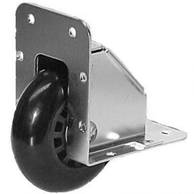

Iconfabul8 wrote:I personally don't think you need guides and rails.
I too can't see where the precision of guides and rails is necessary. If you want to keep the bed from banging against the wall when raising or lowering, perhaps you can use tilt casters such as these:
http://www.reliablehardware.com/mediumrecessedtiltcasterhousing.aspx
One of these could be placed at each of the four bed corners. With a 1/4" to 1/2" clearance, the wheels wouldn't normally contact the walls. If a wheel does come in contact with the sidewall, it would roll and not gouge the wall. If you're concerned about the wheel itself marking the wall - which is probably doubtful since it rolls - you could add 1" aluminum strap along the path of the wheels.

aggie79 wrote:In my example, the casters were for location only.
To the extent your casters aren't actually touching the wall, there will be horizontal play while the bed is in use, thus swinging banging against the walls.
Also need to account for possibility walls not vertical, maybe shelving, windows etc.
