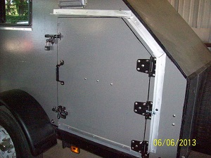

  • I originally built (or at least started the build) my trailer for the wife. She had become involved with a group of wild-eyed Crypto-zoological recon Bigfoot hunters, a few years ago. She wasn't dissuaded from her pursuits, as I was too busy working, and dragracing on weekends. I probably met stranger humanoids at work or at the dragstrip, every day, than she was likely to meet in the woods of the midwest (her Bigfoot group's favorite area; you just don't mess! with Texas Squatches, I guess).
  • I was trying to get her out of a ground tent, off the wet earth, and put solid walls between her and whatever might be out there, doing the hollering she heard at night, on her trips. I built the walls, roof, and floor of steel-braced 3/4" plywood, and the doors were just windowless cut-outs from the walls. I put in two, small, safety glass windows, high up, so a large hairy arm would have to fish around before grabbing her.
  • I also wanted her to have two doors, so escape would be possible from one, if the other door was blocked. Both doors were triple-hinged, and quadruple-locked, to keep daytime thieves at bay, and both doors had two gate-type slide bolts that could be locked OPEN, so she wouldn't get locked in.
    outside door security.jpg (93.67 KiB) Viewed 2485 times
    very strong hardware to deter quick entry into cabin

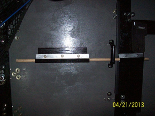

  • Once inside for the night, she could pull both doors tightly closed (the doors have automotive door compression seals), and snap 3/4" round oak dowels into the channels on door and doorframe, made to receive them. Oak dowels have an incredible resistance to shearing forces, and will keep out the juvenile hominids, at least, for awhile.
    inside door security.jpg (128.76 KiB) Viewed 2485 times
    my variation of a drop-in bar
