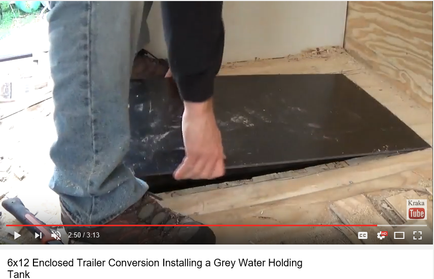

I came across this video. It looks like a good method. He basically cut out the floor the same thickness as the lip on the tank so it sits flush with the floor. The only disadvantage I can see is if you need to remove the tank you need to remove whatever is above it instead of dropping it out the bottom.

Some of the TT I scraped were this way. Others just a hole- some not even round for the stool mount. Plumbers helper from/to frame members. Maybe a screw in each corner. And almost all had the drain ripped off and repaired.

Padilen - Good to know. Do you think the method shown in the picture above is better than installing under the floor for that little bit of extra clearance and safety reasons? I've seen people weld L brackets to their joists for the lip to sit on. But then its an inch or two lower and you lose some width with the lip holding part of the L.

It's not better nor worse. Just another possibility for some people. Guess I'd figure what I wanted, what would work/fit. Then I'd look at my options for mounting. My shower/toilet tank combo isn't orientated the way I planned. But it's the way the drain would clear frame members. Actually may have worked out for the better, as my drain valve is tucked up behind A frame of tongue.
