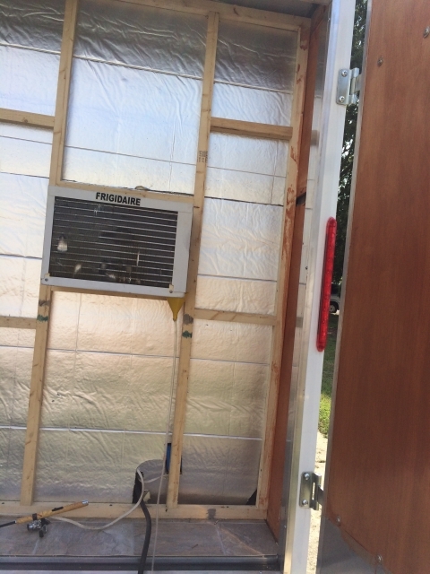

We have an AC in the back wall and it worked great. The only problem, how do you keep the rain out when it is in use? It rained a lot getting the door and the outside of the back wall and floor got a little wet. I'll post some pictures today to show our progress.

Postby pchast » Wed Aug 23, 2017 9:30 pm
raise the tongue just a hair?
gasket the wall base?
Seal the floor to shed water?

Postby Iconfabul8 » Thu Aug 24, 2017 12:03 am
kaloogle wrote:Hi all, we picked up our trailer a few months ago and have gotten a lot done. It is insulated, we built bunk beds for the kids, and put a temporary back wall in. We took the camper out once and have used it at home a few times.
How about a 3 or 4ft awning type thing. Also :pictures: !!!!!

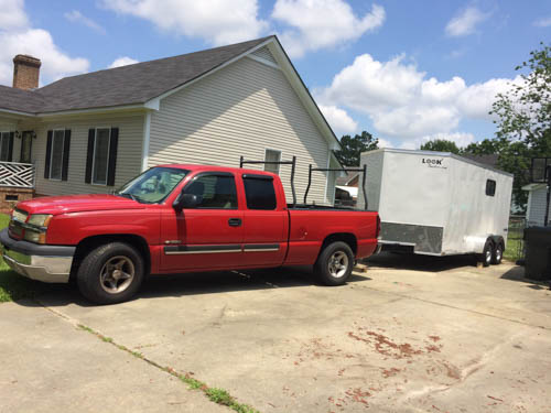

Sorry for the delay in posting some pictures. Most of the work we have done is temp to figure out what we want and where.

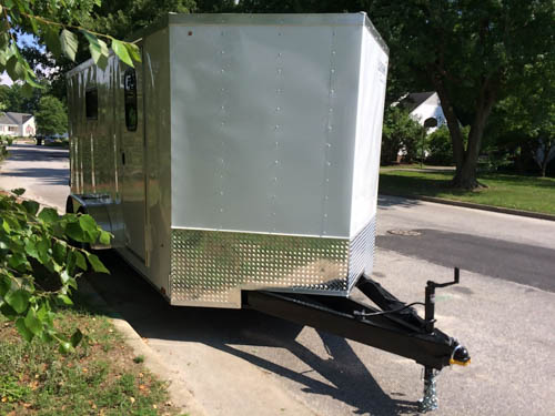

Just a pic of the trailer:
Truck and trailer:

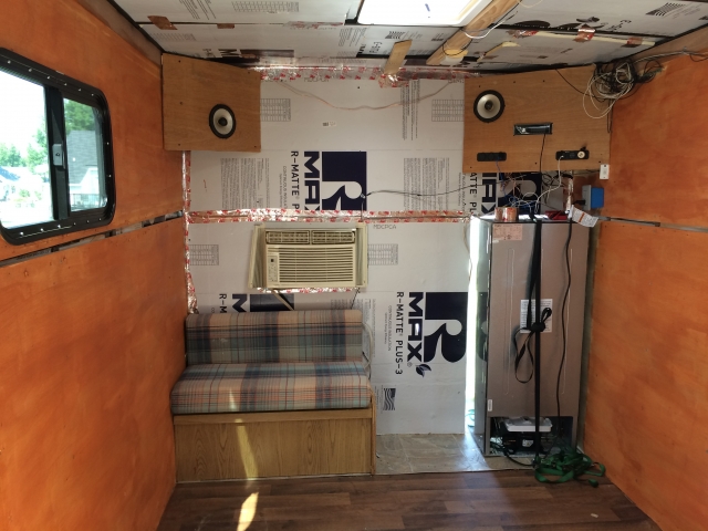

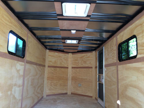

Inside before we started work:
The kids like robots:

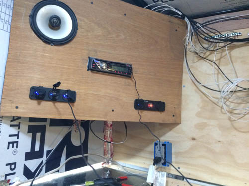

Testing the radio, before putting on outlet cover:

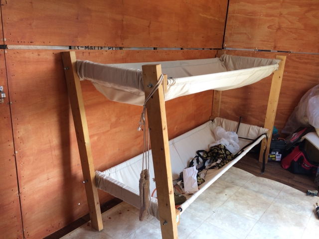

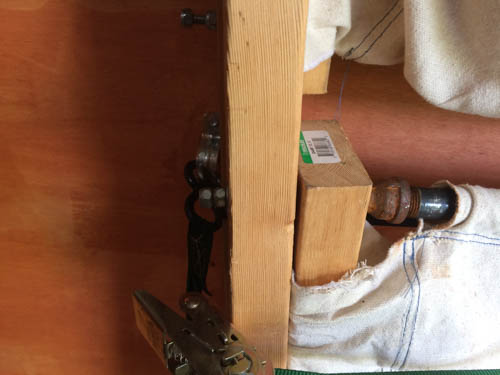

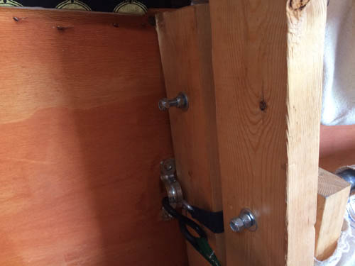

Folding wooden bunkbeds. These worked good on our first trip, but they are a little heavy. To install them I had a ratchet strap holding them on the wall and then another when we wanted them out of the way.

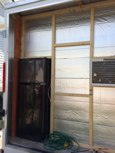

The AC, the little funnel and hose is for the drain:

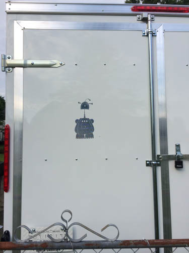

The back wall from the outside:

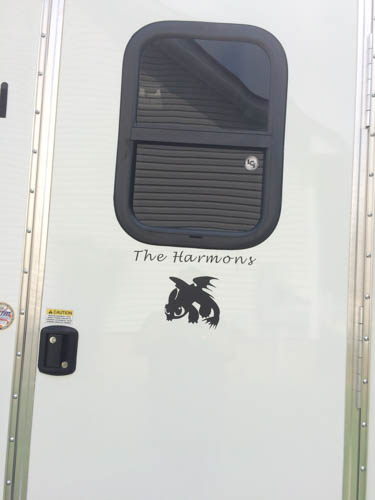

Front door:

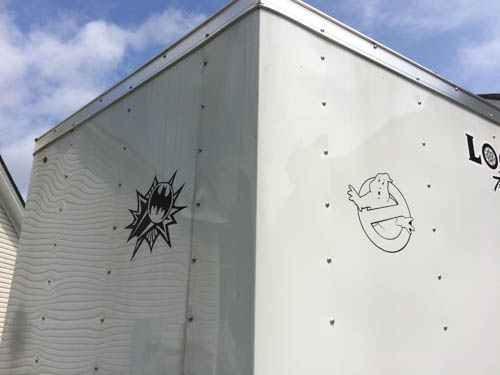

Front V - the decals were made on a Cricut using google images and vinyl.

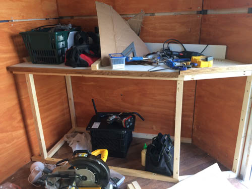

Front counter:

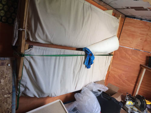

Bunk beds folded up:

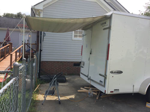

Back awning off of an old popup camper. The back doors are hitting it and will rip a hole in it. I need to put a roller or somethink on the sharp corner. This one is a little pain to slide on and off, takes 2 people. I'm thinking of taking it to a shoe repair place and see how much for a new zipper. Once a new zipper is installed, I'll just leave it on the back.

Postby hankaye » Wed Sep 06, 2017 7:13 pm
kaloogle, Howdy;
For that awning zipper (slide fastener), repair, I think you mentioned you are near the coast in the Carolinas,
Best bet is a Marine canvas shop or boat cover business. They generally have sewing machines that eat that
stuff as an appetizer. I've seen machines that will sew 2 quarters to make a unique 50 cent piece.

Postby Bearbait in NM » Fri Sep 08, 2017 11:40 am
For the "slide" on top of the doors to protect my awnings, I am using a length of pvc pipe. Take the length, and cut a slot lengthwise that will fit the thickness of the door at the top. The curved pvc will slide easily on the awning, and if you make the slit a little snug on the door, it will stay. They come off easily to store, and weigh nothing.

Thanks for the suggestions, I was able to find some pipe insulation that fixed the problem with the top of the door rubbing the tarp/canopy.
