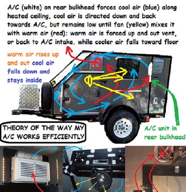

Postby working on it » Wed May 24, 2017 9:17 pm
  • Part of the reason my home A/C works so well for me is that we use air circulators at (various heights) to move the cooled air into areas that would otherwise have hot spots, or stagnant pools of air. Ceiling fans, pedestal fans, and floor fans all contribute to the overall scheme, since each type can reach areas the others may not be able to influence, due to hidden corners, furniture in the way, or just out-of-the-way spaces where the A/C fans can't directly affect circulation. Using an independent fan in an air conditioned trailer may make even a smaller unit more efficient, and short-cycle less (if at all), due to being able to handle more air volume that needs cooling, than if working alone.
  • I use a similar scheme in my small 4x8 TTT, to circulate the warm and cold strata of air, to effectively induce the cooler air to first cool the sun-heated ceiling, and return by deflection off of the 45 degree sloped front panel, and cool me at the rear wall. Helped by a 10" air circulator, aimed towards the rear, the cooled air sinks downward, displacing warmer air, which rises up, and eventually is either sucked into the A/C intake, or out of the open vents near the ceiling (warm air rises, cool air falls, etc...). My TTT is only 88 cubic feet inside, and though the 5k BTU A/C unit is nominally too large for the area being cooled, using air circulation and open ceiling vents makes my system cool really well, without short-cycling. I've never turned it to high, and keep the thermostat at halfway or less, and it has worked great for me, and never failed to dehumidify while cooling. Perhaps the complete air circulation is a key; I don't know for sure, but it's worth mentioning.
    warm air rising up and out.jpg (154.32 KiB) Viewed 4213 times
