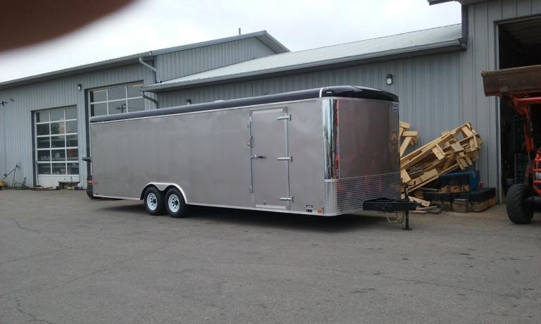

Nice work. I will be watching with interest as I just picked up my trailer with the same goal in mind.
I also special ordered my trailer to get the basic starting point exactly as I wanted it. It was well worth the wait. One of my main concerns was the height of the wheel well boxes on the inside as I have 2 cars with the bottom of the doors only 10" off the ground. I was able to order my trailer with the axles 2" lower relative to the frame which yielded 8" tall boxes inside. I also ordered a 2' longer box(26'), upgrade 6" tall frame & cross members to 8", reduced the side door from 48" to RV size and moved it forward to 32" from the front corner of the box. These changes were at little or no cost compared to the std. trailer. My salesman suggested ordering it in "Champagne" instead of white or black and I am very happy that I took him up on that.
