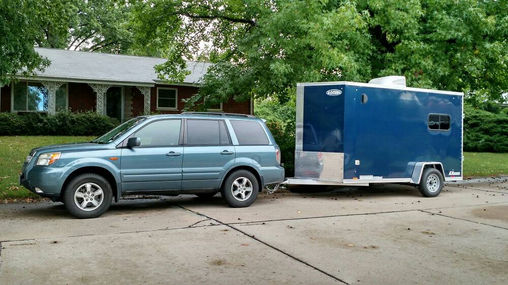

Postby Ransom » Sun Jun 11, 2017 10:54 am
Here's my trailer.
