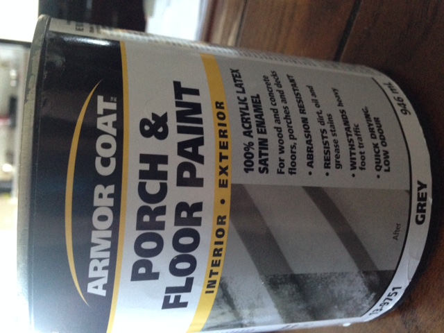

I have been thinking of painting the inside wood floor and using either a area rug or foam tiles on top. What does everyone use for floor paint?

low277 wrote:I have been thinking of painting the inside wood floor and using either a area rug or foam tiles on top. What does everyone use for floor paint?
i used this stuff, seems to be a decent product

Postby Vspec » Thu Jun 22, 2017 6:12 am
I just used a Behr outdoor primer for wood and Behr 1 part expoxy garage floor paint and couple of days later, I have not had any issue. It looks like it will dry into a really hard finish. I could have probably skipped the primer part however.
