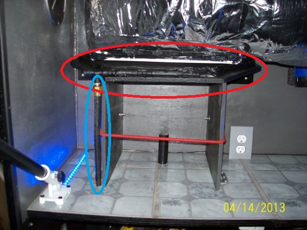

  • Some A/C units use up most, or all, of the condensation water produced by the cooling process, to cool the hot condenser for better performance. I use several different window A/C units at home, and some drip water in abundance, others do not. My two Frigidaire 15100 btu units practically gush water from the rear, my Frigidaire 10000 btu unit produces little excess (you can hear the water slinging inside the unit), and the LG 8000 btu unit uses up all the water, while self-cooling. My TTT uses a LG 5000 btu unit (LW5012J), that also uses all the condensate, and never has produced excess. I built a drain/drip pan in my galley,just in case it would have excess drainage, but hasn't needed it yet (I hadn't tested before I constructed the drain pan and hose, but it is also used in my exhaust duct system, anyway). I chose the trailers' A/C because I knew the LG wouldn't create a messy excess (my large Frigidaires do), so I chose it. Mine had a sealed pan under it, while its' sister model utilized a drain.
    Drip pan and stand.png (612.54 KiB) Viewed 4010 times
    red=drain/drip pan; blue=drain hose to ground

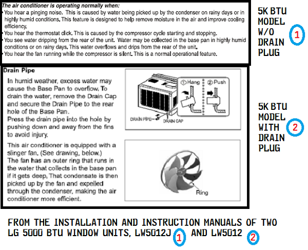

    drain pan variations.png (185.07 KiB) Viewed 4010 times
    practically identical, but one has no need for a drain hole

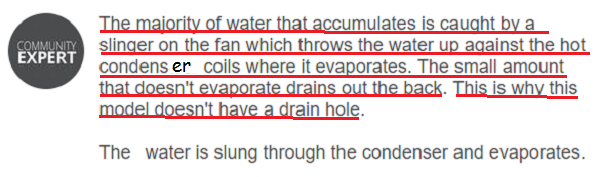

  • There are many other models out there, some with drains and others without, but if your A/C is internally-mounted, like my trailer's unit, then a drainage system might be needed, in case of excessive water, beyond what the unit needs for self-cooling.
    reason for no drain hole.PNG (66.14 KiB) Viewed 4010 times
    copied off the internet

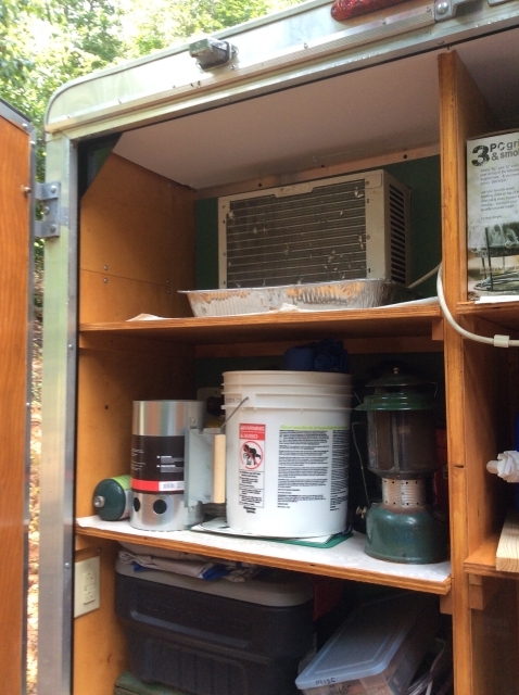

Postby lrrowe » Sat Jul 01, 2017 8:04 pm
My 5000 BTU does not have a drain hole and no condensation comes out of it.

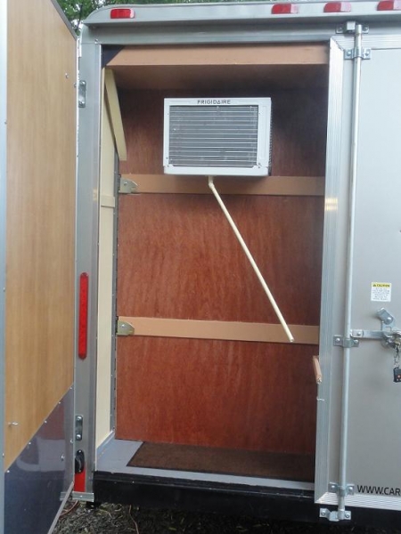

I drilled my drain pan since my entire unit sits inside the trailer. Hard to see in the picture but I mounted a cpvc 1/2" 90 degree flange fitting, capped one end, and put a 45 on the other so I could put the drain line out to exit the trailer through the partially opened door. Mine too was designed to evaporate the condensation, but I didn't want the excess water to slosh out when traveling, and I also didn't want the pinging noise going on all the time. Seems to cool just fine. I also have a short pipe/cap setup to plug it when I remove the drain pipe. One time I forgot to remove the plug, wondered what that pinging noise was, swapped plug for drain pipe, ran a river of water out then.
I drilled through the inside of the 90, exiting the flat between the ears, automotive gasket sealer, self tapping screws, mounted to the low point on the A/C drain pan in line with the hole I had already drilled, presto.

NO David! wrote:I drilled my drain pan since my entire unit sits inside the trailer. Hard to see in the picture but I mounted a cpvc 1/2" 90 degree flange fitting, capped one end, and put a 45 on the other so I could put the drain line out to exit the trailer through the partially opened door. Mine too was designed to evaporate the condensation, but I didn't want the excess water to slosh out when traveling, and I also didn't want the pinging noise going on all the time. Seems to cool just fine. I also have a short pipe/cap setup to plug it when I remove the drain pipe. One time I forgot to remove the plug, wondered what that pinging noise was, swapped plug for drain pipe, ran a river of water out then.
No David, your AC placement is very similar to mine. I have an aluminum catch pan under it and would add a tube should there ever be water in it. But to date, there has been none.
