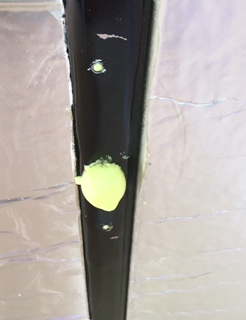

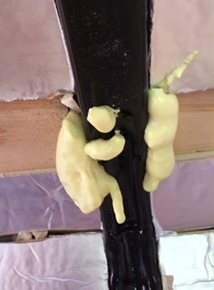

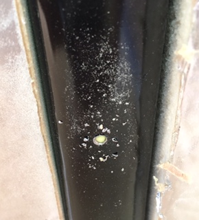

Postby fourbtgait » Sun Jul 16, 2017 11:44 am
Insulated roof bows.
6 bows, 5 cans non-bowing great stuff, plus misc gaps to use up last bit in cans.
I thought of doing a pvc pipe as a test, but why, when my ct had 1" holes drilled in two of the roof bows when they installed two lights. So I found a 3' section of vacumn line that fit over the straw of the foam can. I fed the hose down to the curve of the bow, started slowly filling and pulling hose back out. I can hear the foam in the tube, had empty screw holes ocassionally to gauge filling. Got to the center, reinserted hose to fill the other side of bow same way. It did not make it all the way down into the curve of the bow, so drilled a 5/16 hole there and fed the straw up and down to fill it.
Is it 100% foam filled? Doubtful, but only destructive testing would show. I would be satisfied with 50% filling rate, better than zero. Roof skin distortion? None as the foam is designed not to.
Clean up of straws and hose with acetone allows resuse of all. I still have 3 never used straws.
Midspan screw hole showing fill
Curvature fill
Original drilled hole. Ones on either side are screw holes
