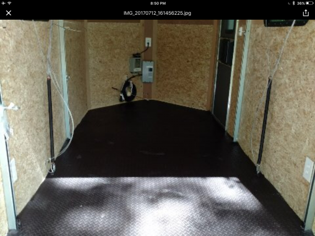

Yay! I got the flooring in today. A pretty tight fit from side to side. A bit of a gap in the front, but I think 2 metal strips for flooring should take care of that, since that area is storage anyway. I hope silicone will suffice for the gap in back. Thinking I wo need to glue the flooring down. Once the compact kitchen unit is in, that floor isn't going anywhere and a silicone seal all around should keep water out. Hope pics post. I had some problems getting them uploaded. [album][/album]

Hope you left enough room for expansion side to side..........
I had my work buckle once! :oops:

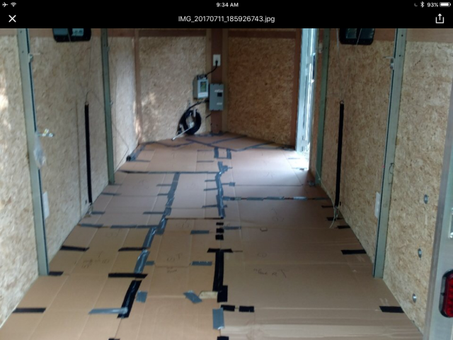

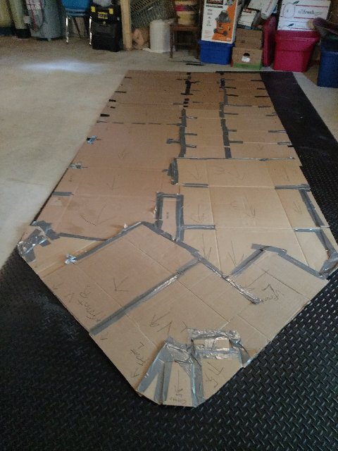

That does look good. Nice job on the template, that's a proven method. I had an Avanti similar to that in an efficiency apt. back in the '70s. Man, those were simpler times. I wanna go back...

I don't think that should be an issue. It is rubberized flooring, which is why I wanted a tight fit. I will silicone around the edges to keep water out.

Even with the template, I am about a 1/2 inch short in the front of the V. Part of the template came untapped when we were moving it. I am still debating on how to deal with the gap. t might not be a huge issue, since that area will be storage anyway. If I do a bead of clear silicone along the bottom of whatever cupboard or cabinets we put there, it should keep any water out.

If it's covered I would just seal it with caulk or paint.... if exposed, some nice trim maybe? If it isn't locked down already you could split the difference front to back.
