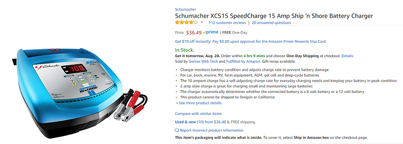

  • I used 110vac extension cords for my park power to trailer (different lengths and gauge according to distance and load), then connected to a GFCI and a re-settable surge protector, and another extension cord inside the trailer (14 gauge, inside an automotive-type grey wire loom), and for exterior lighting (rope lights) plugged into the trailer. All are outdoor type, and my inlet port is waterproof. For 12vdc, I use 4 gauge cables from the battery inside the tonguebox to my master disconnect in the galley, then via 10 gauge wires to a second, 50 amp switch (on the side of a key box, fitted with 1-5 amp automotive fuses for different circuits, and an inverter inside, in case of 110vac failure at night).
  • I also have an onboard 2500 watt generator, with extended-run fuel tank, just in case I need to use 110vac all night, in an emergency. Loud, but available. It can also charge my trailer or truck's batteries (I carry a BatteryMinder 1.5 amp trickle charger for the trailer, primarily, and a Schumacher XCS15 charger - good for either my AGM trailer battery, or for my truck's flooded cell battery).
    cheap, but efficient for use on all type batteries
